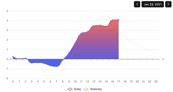

Gradient:
        areaStyle:
          color:
            type: linear
            x: 0
            y: 0
            x2: 0
            y2: 1
            colorStops:
              - offset: 0
                color: red
              - offset: 1
                color: blue
            global: false

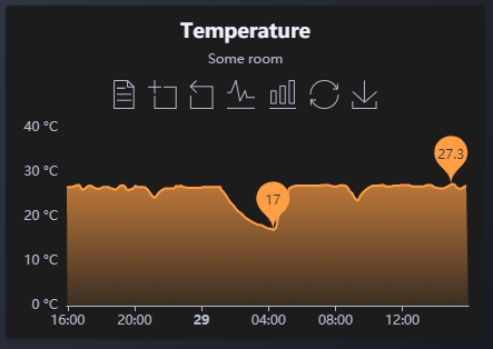

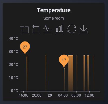

I’m on 3.1 snapshot now, too, and testing around.
One big issue for me: On my android devices the charts are not displayed, neither the chart pages nor the chart widgets.
It will show the legend, the min/max balloons, the points, but not the bars or the lines of the series.
On my PC it works just fine. Any ideas?

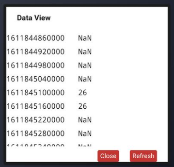

Similar behaviour here.

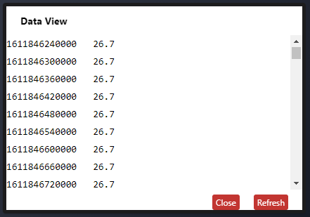

The chart isn’t displayed correctly on my Andorid device (Android 8.0.0 on Samsung Galaxy S8)
I tried to look at the used datapoints and it seems, that somehow not all of the available datapoints can be accessed on mobile (and returns null) - on Desktop all of these datapoints are available.
Mobile:
Desktop:

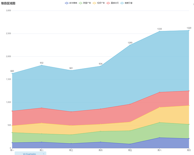

But I have one more question. Is it possible to display several time series on top of each other. I need something like this for my photovoltaic system. The total power consumption is made up of the solar power plus the battery power plus the income from the grid. These three values added together give the total consumption. Can I display this in the graph? I found a similar example in the dikumentantion of the echarts. I can’t get this to work though.
Try adding
- component: oh-time-series
      stack: 1
      stack: 1
