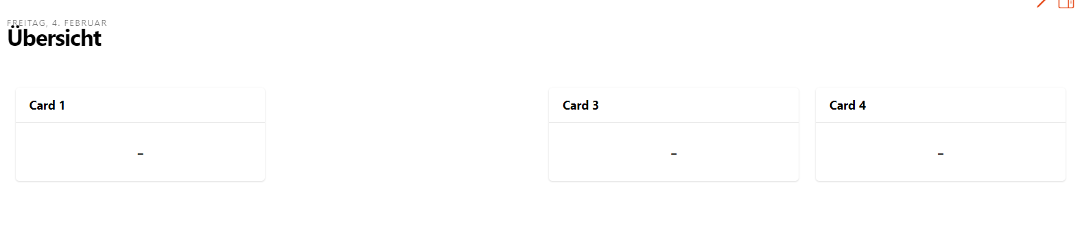

There is the issue within Main UI, that if a card is set to visible: false, the UI will still show a blank placeholder.
Sample:
card 2 is set to visible: false & is missing
there is unnecessary space between card 1 & 3

I have just found one topic describing the issue, but the topic is already from end of 2020.
As I am also facing the issue and think about how to deal with it, I wanted to check if anyone knows if there is a workaround or if this will be addressed in future?
