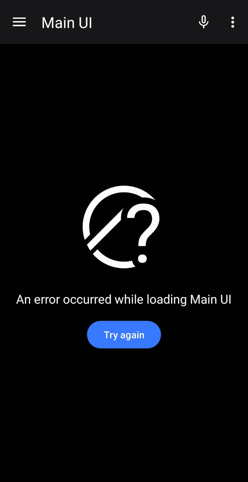

  • Issue with the topic: Suddenly, I am unable to access the Main UI on 5G.
Today, Openhab 5.1.1 became inaccessible from 5G, while it works perfectly via Wi-Fi, noting nothing changed in the sense that no configuration was touched.
  1. The message initially is that while the cloud is accessible, the instance itself is offline. I got home and found that it is working fine on wifi.
  2. I rebooted the Docker container
  3. I completely uninstalled and reinstalled OpenHAB. That did not fix the issue. The message this time, “An error occurred while loading Main UI” click on “Try Again” for a fraction of a second, shows “Unauthorized”

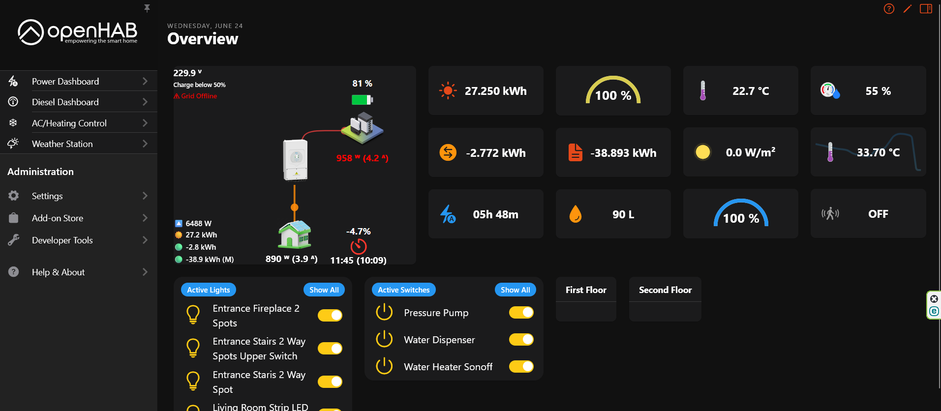

Yes, on Wi-Fi, it works well on a browser (see image below)
I am able to access myopenhab.org properly with my credentials, and the main UI seems to be loading (which never loaded for me, too slow).

This is different. The issue is shown below
When clicking try again you will spot “Unauthorized”
Yes this is excactly the same behavoir.
