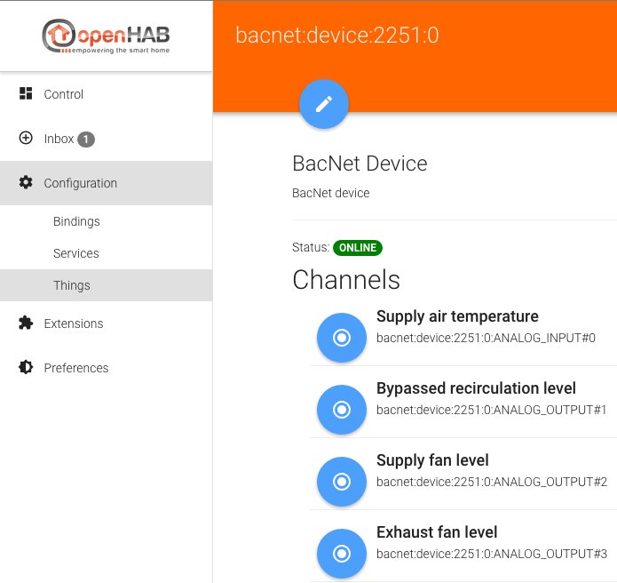

Splastch,
It’s possible to test your binding version 2… ?
https://twitter.com/ldywicki/status/750231967862558720?lang=fr

I restarted efforts in area of openHAB 2 addon but dont have working version yet.
Earlier screenshot was done before OH2 was releases. Sadly I lost all this code in transition. As soon as I will have working snapshot I will publish it. I believe it will solve many issues caused by configuration; however there are also many areas where BACnet exceeds HAB capabilities by complexity.
Many of advanced object types will remain unsupported, unless hacked through openHAB type system.
