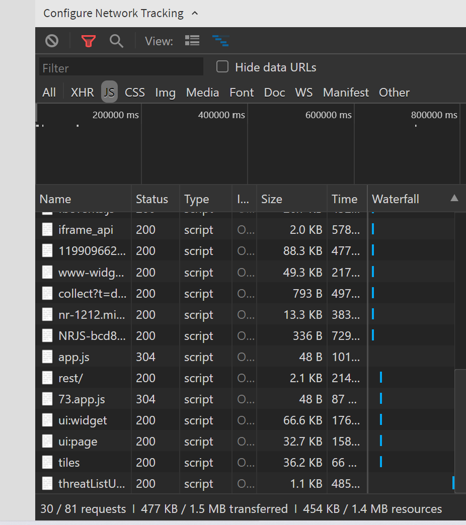

I think I found the culprit.
After a while the browser makes a call to this website:
safebrowsing.googleapis.com
after that app.js is not “connected” anymore

Is this remote debugging on your iPad, it looks like Chrome’s dev tools?
Anyways there are a number of scripts that aren’t related to the UI - basically everything above app.js on that screenshot, and the last “threatListU…”. Maybe that’s normal if you display iframes, they could be interfering, try removing those iframes temporarily if you have them, and see if it fixes the problem.
Hi Yannik,
yes, I used the link you provided above. the screenshot is taken from there (it starts a virtual iOS device embedded within inspection tools which look like chrome dev tools).
The last entry you see and what you mentioned (threatListU…) is exactly what causes the problem. I saw it with my own eyes in realtime. “threatListU…” appeared after a few minutes and instantly all widgets lost their status.
If you hover on threatListU., you saw that it was calling safebrowsing.googleapis.com/
EDIT: at the same time, the blue bar next to app.js disappeared
