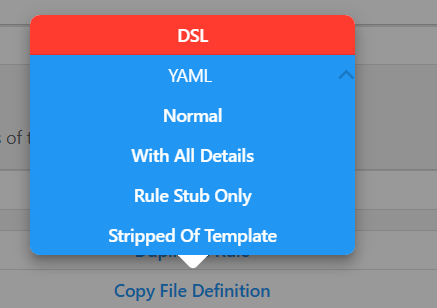

This is the popover as of now
    <f7-popover id="file-definition-popover">
      <f7-block-header class="margin-left margin-top">Select format:</f7-block-header>
      <f7-list>
        <f7-list-button color="red" @click="something"> DSL </f7-list-button>
        <f7-list-button v-if="isEditable || (!hasOpaqueModule && !hasSharedContextModule)" color="blue" @click="somethingelse"> YAML </f7-list-button>
        <f7-list-button color="blue" @click="something"> YAML with all details </f7-list-button>
        <f7-list-button color="blue" @click="something"> YAML Rule Stub </f7-list-button>
        <f7-list-button color="blue" @click="something"> YAML with temlate stripped </f7-list-button>
      </f7-list>
    </f7-popover>

Argh, it seems that popover is useless, because it can’t handle that the size is changing. Forget the styling of the buttons in this example, just look at what it does with the arrow to the “parent element”:
If expanded when opened:
..after being collapsed:
If collapsed when opened:
..after being expanded:
It even expands outside the viewport without “caring”. It is always anchored in the top, regardless of where the “parent arrow” is, so it simply can’t be used when you need a sub-sub-menu. Argh!
