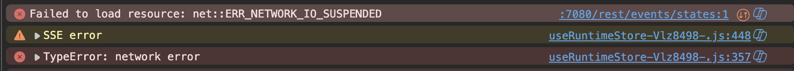

So perhaps it’s because the browser puts inactive tabs to sleep.
The fix needs to be done in core. MainUI needs to be tweaked to gracefully show the login page when this occurred instead of just acting weird on whatever page the user is currently on.
