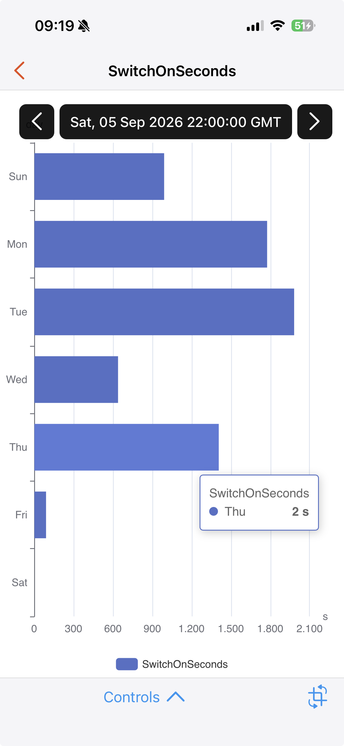

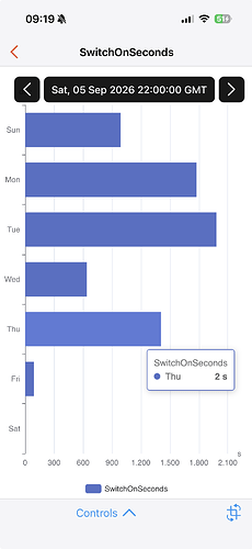

when i try to aggregate data and take a look on the tooltip on IOS i see an index like 1,2,3,4,5,6 (s) instead of the value.

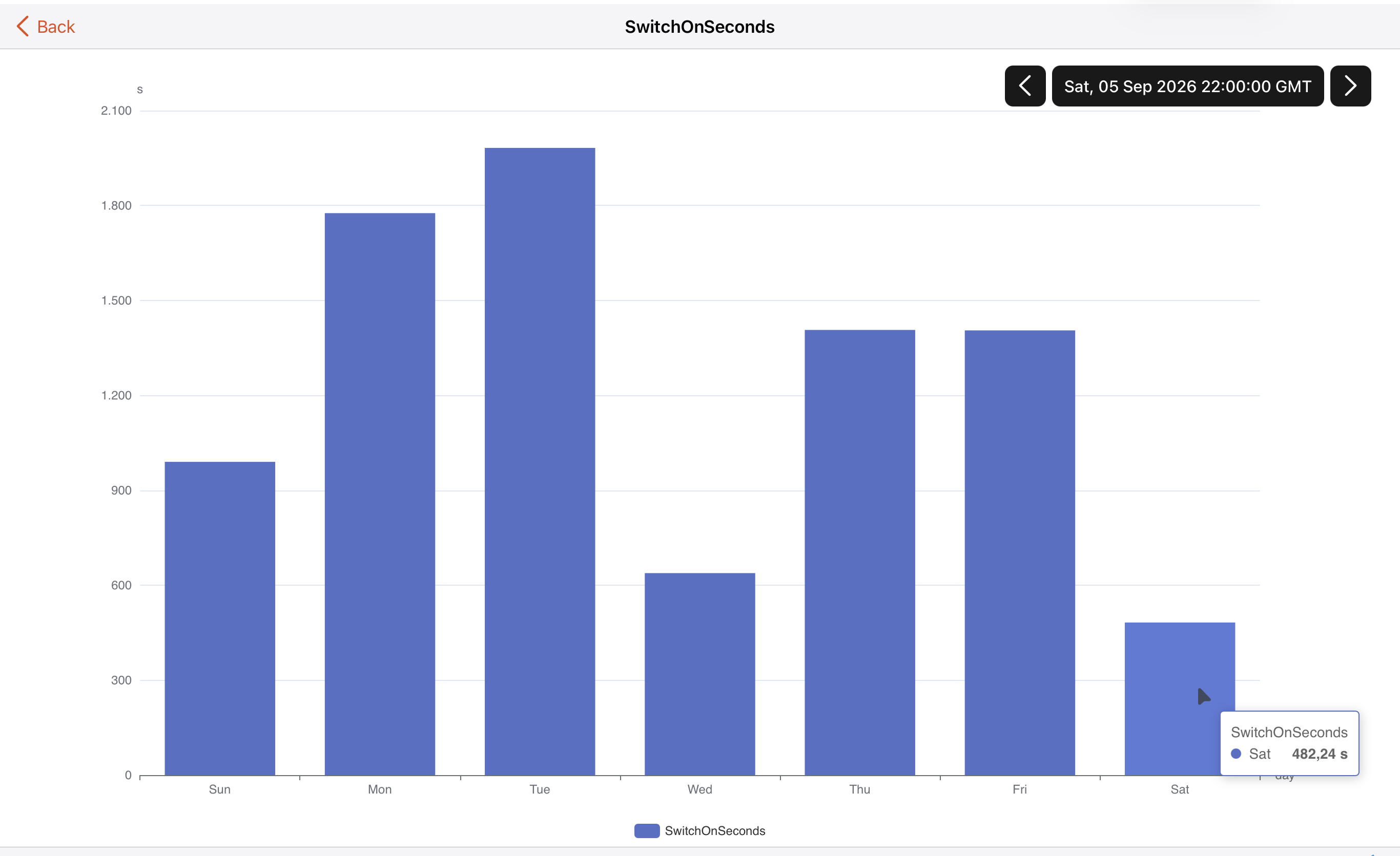

Hi thanks for your reply,
When i use my tablet then the figures look right.
But when i press the „rotate“ icon on bottom right it turns back to the issue:

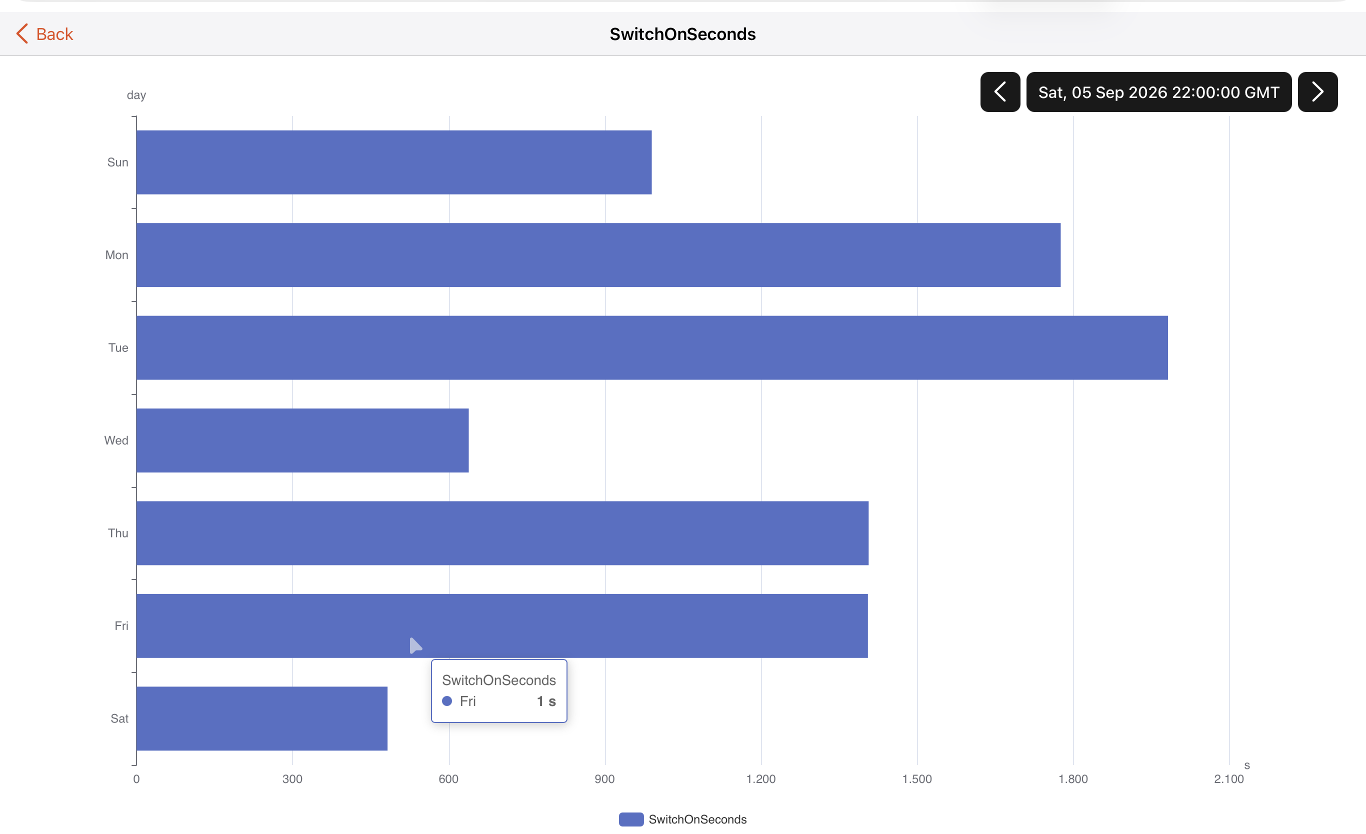

As shown above it depends if its rotated or not and not if its desktop or mobile.

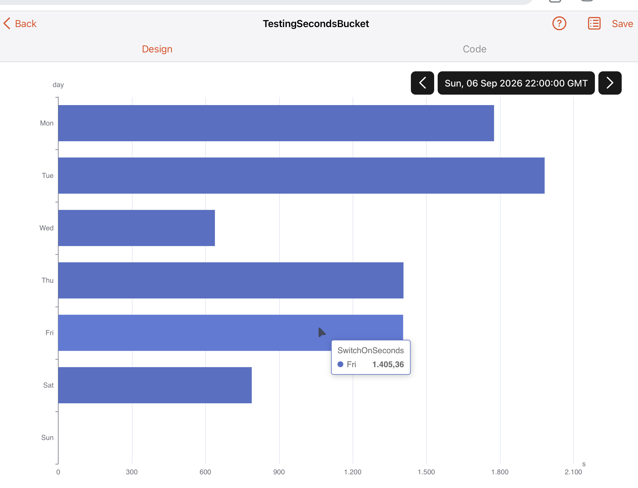

When i save the page and uncheck the smart tool tip then it also works.
I assume this is given because in 90° switched view it works
