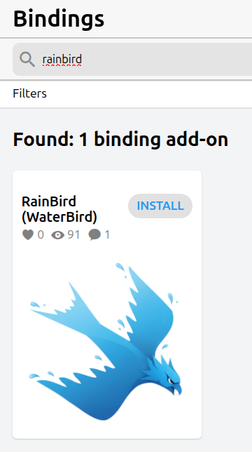

So I tried with my other bindings: MyLight and AirZone, they don’t show up either.
I tried again with others not from me, and here is a little sample of the results:

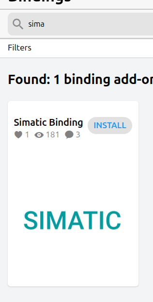

simatic: KO
awtrix: KO
soundcloud: KO
ebus: OK
rainbird: OK

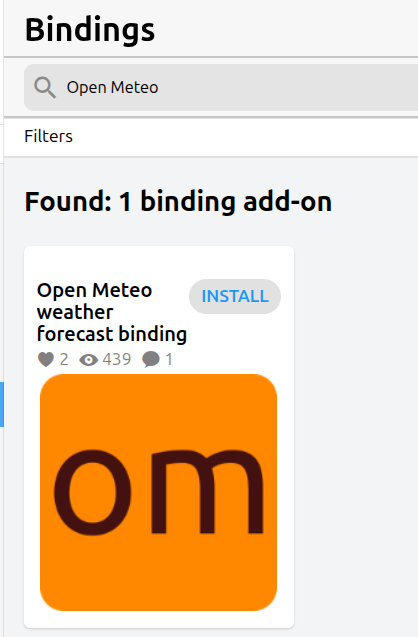

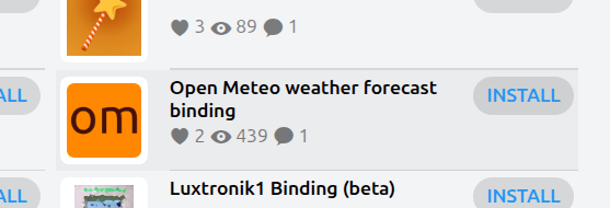

It shows up for me.
Clicking through to the forum posting leads to the correct one.
Search works too.

Yes, because I just changed the version number to use three components instead of four, proving my point.

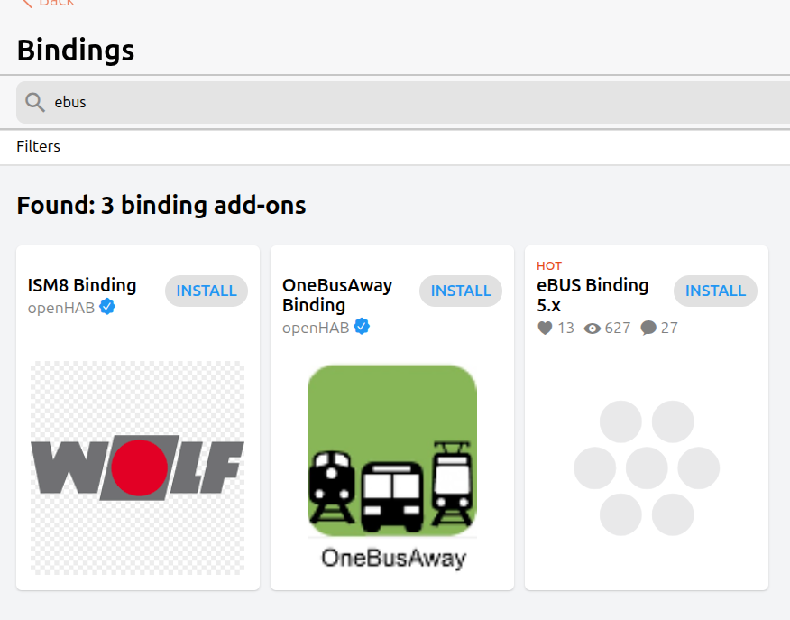

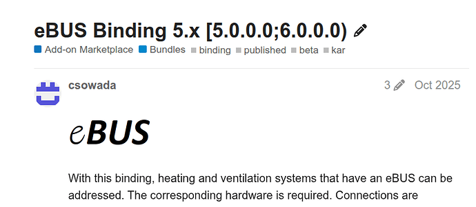

And only one of the others are missing for me either. eBus in particular shows up and it has the four digit versioning.
It showed up before my reply above but you’ve changed it so :person_shrugging:
The only Awtrix binding I can find on the forum has [4.1.0.0;5.0.0.0) so it wouldn’t show up in OH 5 at all anyway. The version is for up to 5.0.0.0 non inclusive but even if I’m remembering wrong and it is inclusive, anything > 5.0.0.0 would still be excluded.
Soundcloud indeed does not show up for me.
eBus shows up and has the 4 number versioning for sure.
At least one add-on with four numbers in the versions show up for me. And all of my rule tempaltes have four numbers in the versions and they all show up.

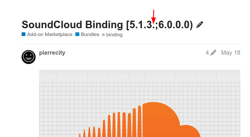

Soundcloud is not showing up because there is an error in the versioning.
It also lacks the “published” tag so it will not show up in the list because it’s not published.
You can go to Settings → Community Marketplace and toggle on “show unpublished” and it will show up in the list despite these two problems.

After a restart of OH5, I see all the plugins that I was not seeing.
