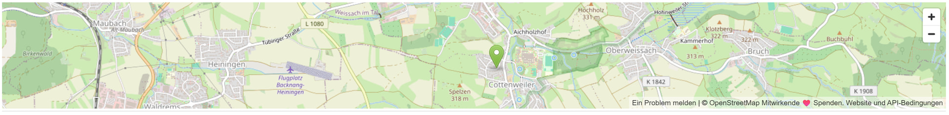

Map function for the location under regional settings not functional
Map view of the location under reginal settings of MainUI is not functional.

Another observation, probably also related to this issue: bindings which use OpenStreetMap show a map (e.g. MercedesMe or iCloud). But the map can only be zoomed and unzoomed by the mouse. Using +/- in the upper right corner of the map, only the “+” works out (zoom) but “-” doesn’t unzoom.

Is this in Basic UI? Doesn’t look like Main UI to me. Please always provide that context.
If it is in Basic UI, it might be a OpenStreetMap embedding, and it seems OSM itself has an issue wit their “-” button at the moment: on the embeddable iframe maps, the zoom-out button (-) does not work · Issue #7287 · openstreetmap/openstreetmap-website · GitHub
I can confirm that: openHAB 5.2, BasicUI, OSM zoom-out does not work.
It seems like Basic UI is embedding OSM from the look of the screenshot, so this is on the embeddable iframe maps, the zoom-out button (-) does not work · Issue #7287 · openstreetmap/openstreetmap-website · GitHub.
Our openHAB Foundation website is also affected by this: Contact the Foundation | openHAB Foundation e.V.
Installed 5.2.1 Release Build and can confirm that the map of my location under regional settings is back. Thanks for this fix. Understood the difference now to the OpenStreetMap issue.
