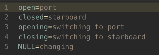

    • Transformation config:
      open=port
      closed=starboard
      opening=switching to port
      closing=switching to starboard
      NULL=changing

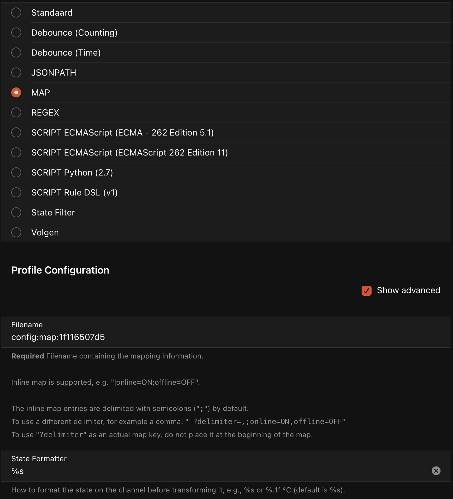

All other values are perfectly transformed, except value “closed” to “starboard”, i tried wit and without quotes on the value, but it doesn’t make a difference. The source of the values is a Shelly rollershutter switch.

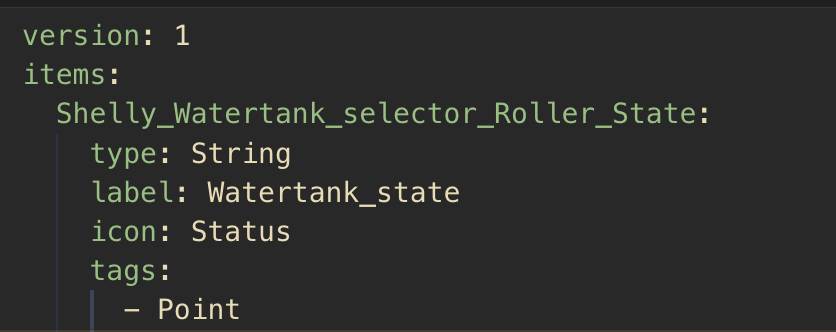

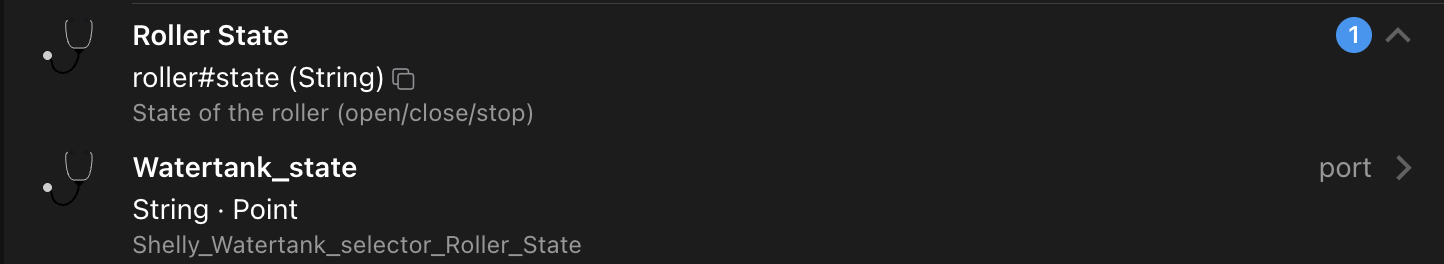

This is my shelly thing & item
This is my transformation:

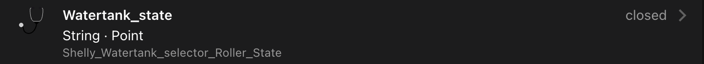

Below is the value shown in closed position:
I copied the value from the item state, just to make sure there is no problem with encoding or something. Still no result…
