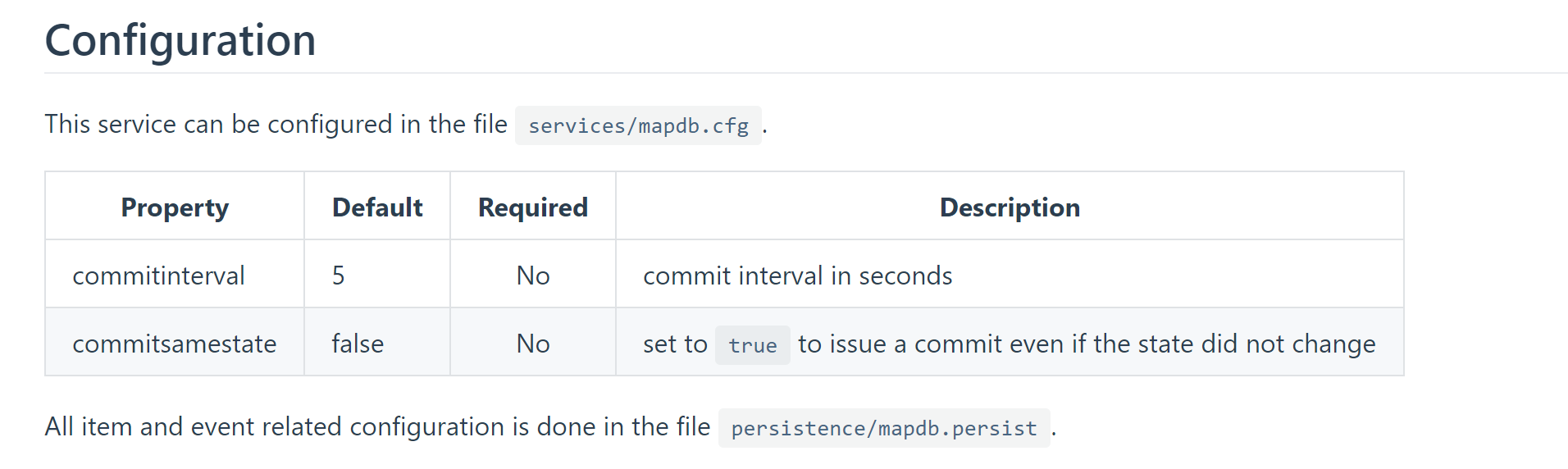

If you use mapdb you likely don’t persist for reporting or graphing purposes but solely to persist states across OH restarts.
You in fact don’t need to persist every change. Just make it everyMinute or everyHour.
And if you run openHABian use menu option 6A to move persistence storage into RAM, that’ll avoid SD wearout and you can continue persisting every second (I can hardly think of a reasonable use case for that but if you want to, you can do).

Any form of persistence will, by it’s very nature, cause IO. I was less worried when it was mysql as that was on a ssd.
If I changed the persistence to 1 minute it only actually writes tthe items that have changed so nothing really to worry about. That would be quite lightweight wouldn’t it?

Be aware that mapdb will only store the current value of the item, you can’t get any historical data other than whendid mapdb store the last time.
mapdb is only to restore an item at startup, but as it’s very likely that the stored value is not the correct current value (a openHAB restart will take some minutes even on fast computers), there is no benefit at all.
