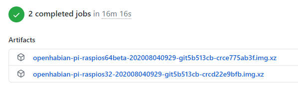

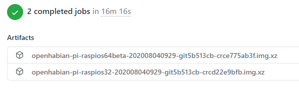

i just spent 10 minutes on this page and couldn’t figure out how to download this latest build.
Yeah, that’s probably not gonna work! i’ll keep my eyes on the other thread you mentioned, mabye this is somehow related to my problems.
click the image link ? :roll_eyes: it takes some time to download.
unzip using winrar or similar.
oooohhhh, you have to login :man_facepalming:
signed out - “not clickable”:
signed in - “clickable”:
