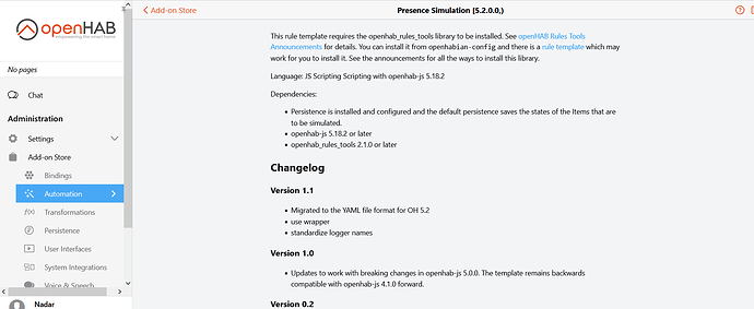

Not sure which link you’re referring to. What version of OH are you using to browse the add-ons? This is what I see in 5.2.0:
@rlkoshak It doesn’t look like [5.2.0.0,) is working, because if it’s recognized as a valid range, it should be hidden when browsing from OH. I know that I suggested support for open-ended ranges a long time ago, but I’m not sure that it was actually accepted… honestly, I can’t remember.
edit: The problem with the version range might simply be that the , should be a ;.

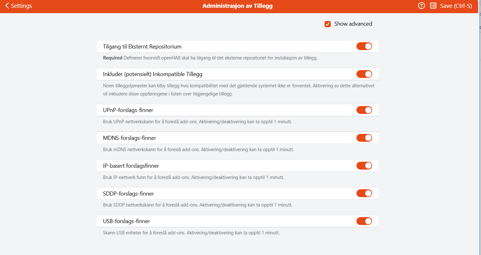

Do you have “Show incompatible add-ons” enabled in the settings or something like that?

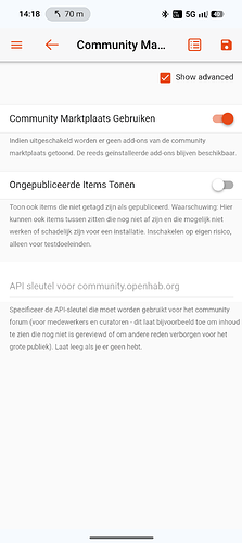

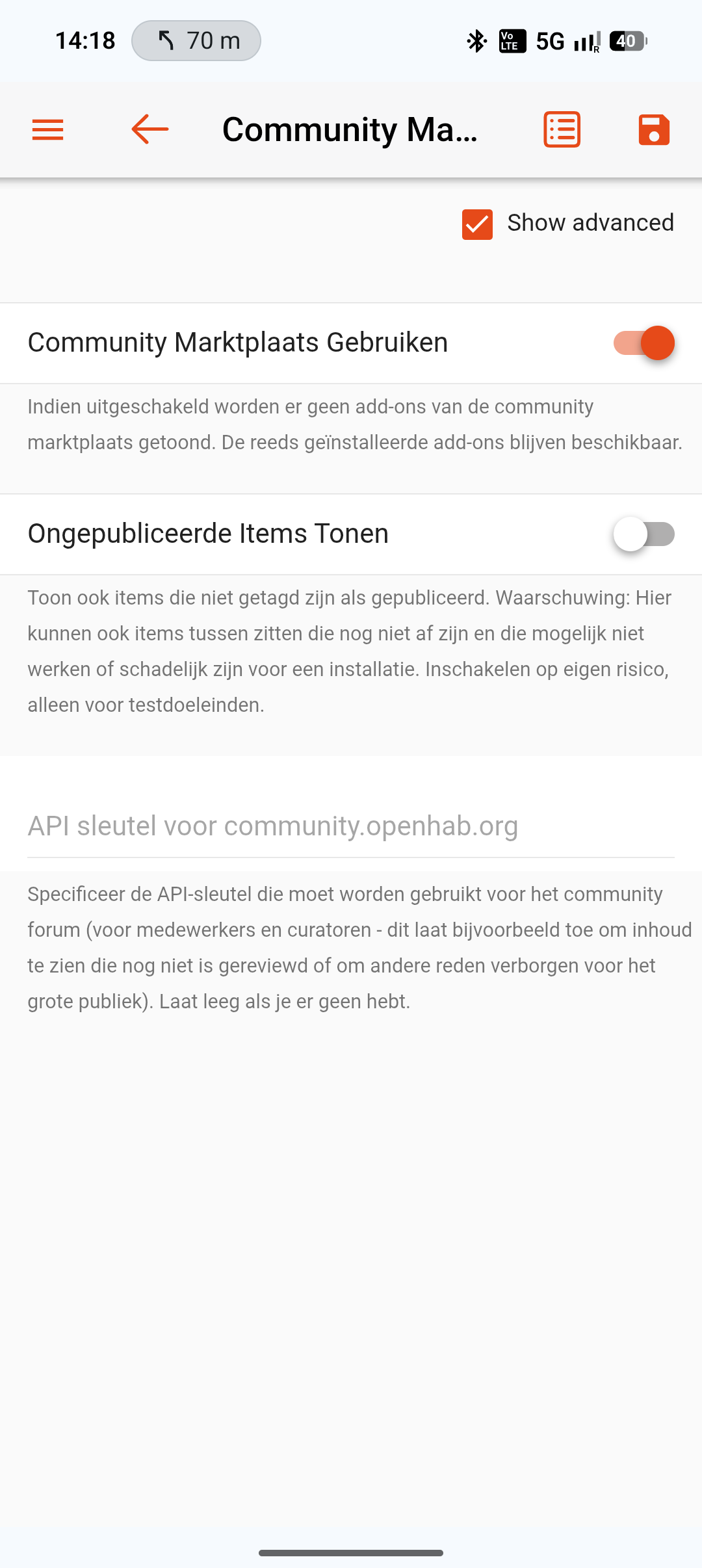

Mmm, where would I find that? I do find this:

That’s one of those twists that’s there just to confuse you. That setting isn’t under “community marketplace”, but under the general “add-on settings”:

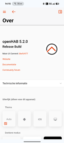

Okay, found it now, and it was set to OFF indeed. Now it’s ON, but no change…
I didn’t mean that you should turn it on. But, when it’s on, you should see two versions of that add-on. Please check if there are two add-ons with that name…

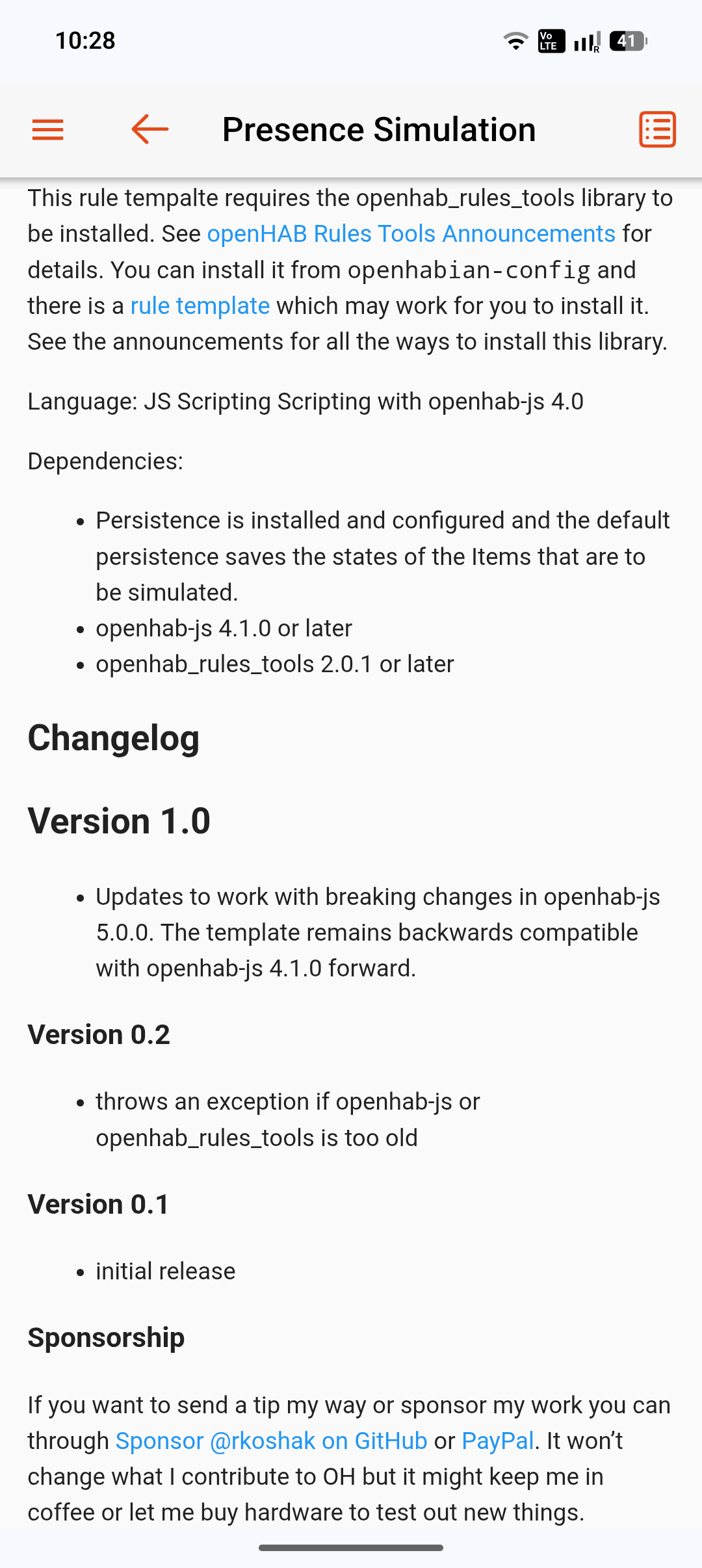

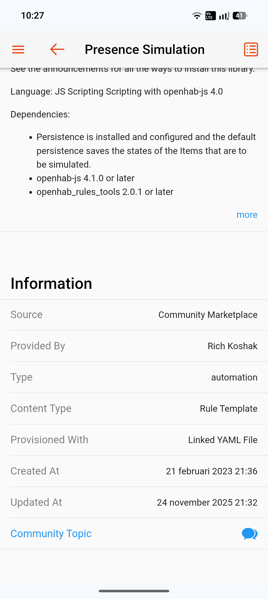

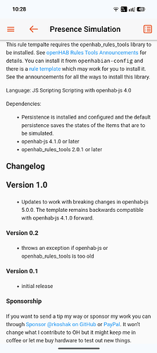

It seems to be half working. It does show up in 5.2 when I have the market place settings to only show published entries. But it is still showing the version number. I’ll try the semicolon instead of comma.
When I get to a computer I will. Normally I don’t really care but for a market place entry it makes it harder to support users of the template.

Mmm, it doesn’t seem updated in the Add-on store:
But I remember reading something about that link being broken, months ago. @Nadahar?
