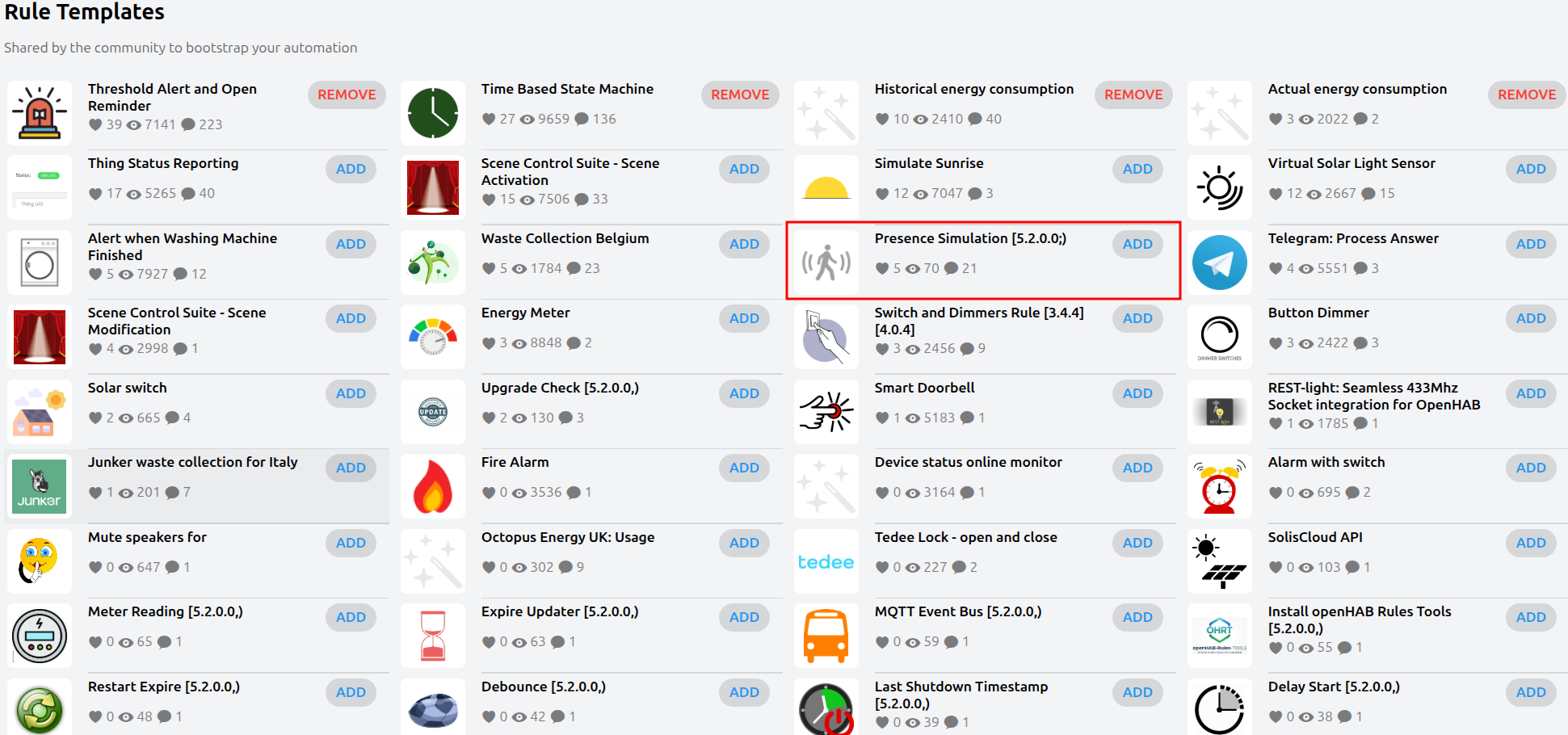

I tried that on the Presense Simulation post and it still shows the version. But I also tried [5.2.0.0,5.9.9.9] at one point and it still showed the version numbering. But I didn’t go back to figure out why. Maybe the semicolon was needed.
Show potentially incompatable is turned off and show unpublished is turned off in my settings.
It shows up because it’s considered to not have a version range ⇒ show in all versions.

Using [5.2.0.0;) doesnt’ appear to work. But using [5.2.0.0;5.9.9.9] does appear to work.
Yes, I don’t think my suggestion for open-ended ranges was ever accepted either.
That form is actually better anyway, because it avoids the whole mess with pre-release versions. If you use [5.2.0.0:6.0.0.0), it will be available in 6.0.0 milestones and release candidates, but I’m not sure if it will in snapshots :confused:
That worked! (The property was just template, apparently…)
