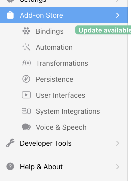

My feature suggestions/wishes are:
  • Notify the user about updated addons in the MainUI:
    • could be like this (dont mind the ugly graphics - just demonstrating concepts):

    • In the respective list of installed components (bindings, automations, UI etc), show components with updates at the top as well so the user easily can see availalbe updates.

I’m not UI expert, but I was thinking that the natural place to show this in the UI would be the same notification that’s used for discovered devices, orphaned links etc. But that might be too itrusive? Anyway, without a implementable plan for how to host/store the Marketplace data, the rest of the details are a bit “premature” IMO.
