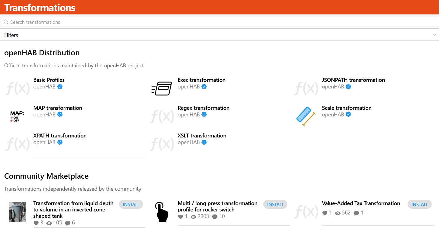

I did a quick tweak to MainUI to test - I’m not saying this is the best way to categorize them, but I just applied a similar logic as is to bindings:
 .../web/src/pages/addons/addons-store.vue               | 17 ++++++++++++++---
 1 file changed, 14 insertions(+), 3 deletions(-)
diff --git a/bundles/org.openhab.ui/web/src/pages/addons/addons-store.vue b/bundles/org.openhab.ui/web/src/pages/addons/addons-store.vue
index 956b092c..ecc437fe 100644
--- a/bundles/org.openhab.ui/web/src/pages/addons/addons-store.vue
+++ b/bundles/org.openhab.ui/web/src/pages/addons/addons-store.vue
@@ -205,10 +205,21 @@
         <addons-section
           v-if="addons && officialAddons"
           @addonButtonClick="addonButtonClick"
-          :addons="unsuggestedAddons.filter((a) => a.type === 'transformation')" :show-all="true"
+          :addons="officialAddons.filter((a) => a.type === 'transformation')" :show-all="true"
           :featured="['transformation-jsonpath', 'transformation-map', 'transformation-regex']"
-          :title="'Transformation Add-ons'"
-          :subtitle="'Translate raw values into processed or human-readable representations'" />
+          :title="'openHAB Distribution'"
+          :subtitle="'Official transformations maintained by the openHAB project'" />
+        <addons-section
+          v-if="addons && addons.marketplace"
+          @addonButtonClick="addonButtonClick"
+          :addons="marketplaceAddons.filter((a) => a.type === 'transformation')"
+          :title="'Community Marketplace'"
+          :subtitle="'Transformations independently released by the community'" />
+        <addons-section
+          v-if="otherAddons && otherAddons.length"
+          :addons="otherAddons.filter((a) => a.type === 'transformation')"
+          :title="'Other Transformations'" />
       </f7-tab>
       <f7-tab id="voice" @tabShow="onTabShow">

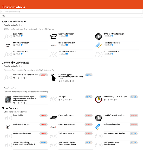

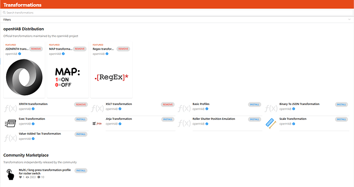

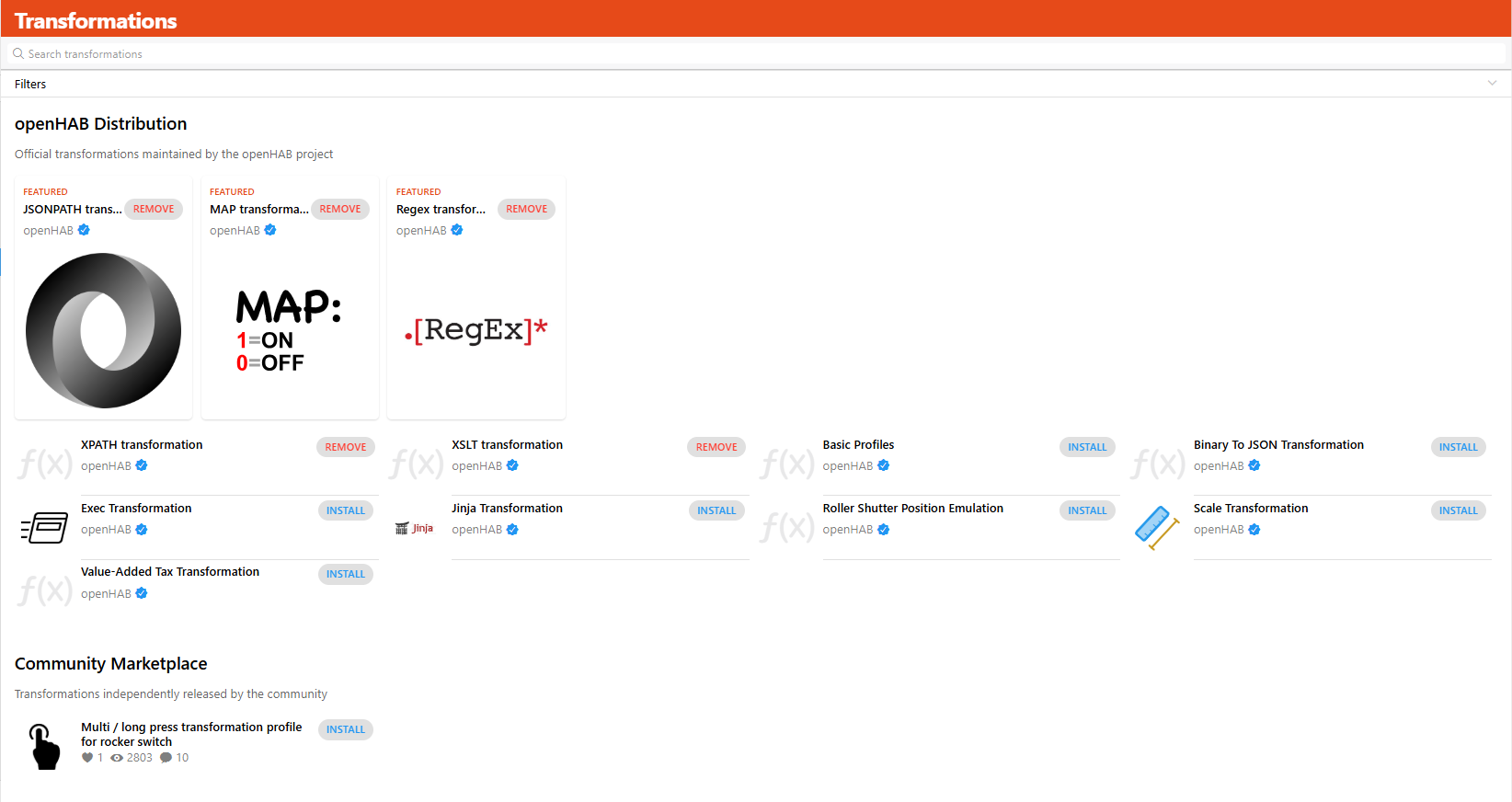

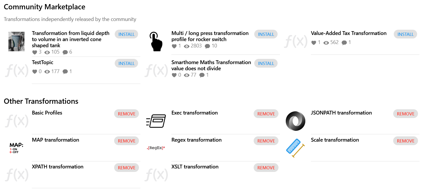

This results in the transformations being shown like this:
It seems like the installed add-ons are also shown under “Other” for some reason, but I have observed that issue with bindings as well (at least some). So, there should probably be some more filtering done on otherAddons().
(Please not that I had to do two screenshots, so “Community Marketplace” is not listed twice as it might appear)
I figured out why some addons were also listen under “Other”, it again has to do with some weirdness of the “demo app”. The “Other” category consists of all add-ons that aren’t of type “eclipse”, “karaf” or “marketplace”:
    otherAddons () {
      return Object.keys(this.addons).filter((k) => k !== 'eclipse' && k !== 'karaf' && k !== 'marketplace').flatMap((k) => this.addons[k]).filter((a) => this.isInFilter(a)).filter((a) => !this.suggestedAddons.includes(a))
In reality that means JARs dropped in the addons folder and those available from a JSON marketplace. For some magical reason, the add-ons provided via Maven/Eclipse are registered both as “eclipse” and as “jar” add-ons when running the “demo app”. So, that’s not actually a “problem”, it’s just another one of those “weirdnesses” that applies to the “demo app”.
So, instead, I started a “webui dev server” (npm start) with my tweaked code that works against the REST API of my production OH installation. There I have nothing under “Other”, and I haven’t enabled “show incompatible & unpublished”, which means that this is the view I get with my above tweak.

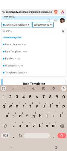

There’s no possibility to categorize them “by type of transformation” without changing things in Core as far as I can see. The way it is done with “automation” is that contentType is used to categorize by. Unfortunately (?), all transformations share the same contentType, so that’s not on option:

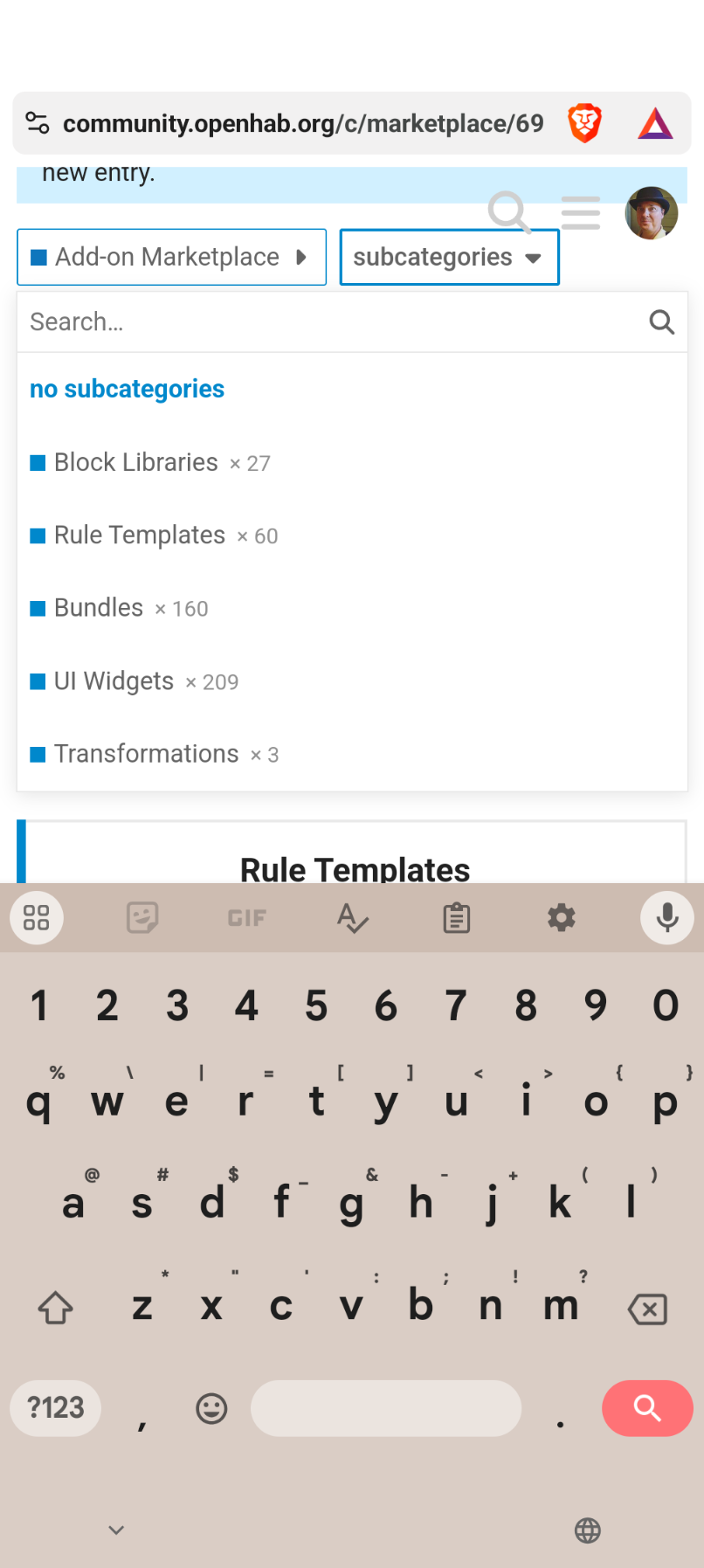

..while the categories come straight from Discourse as integer values:
    private static final Integer BUNDLES_CATEGORY = 73;
    private static final Integer RULETEMPLATES_CATEGORY = 74;
    private static final Integer UIWIDGETS_CATEGORY = 75;
    private static final Integer BLOCKLIBRARIES_CATEGORY = 76;
    private static final Integer TRANSFORMATIONS_CATEGORY = 80;
This is then all “mapped” like this:

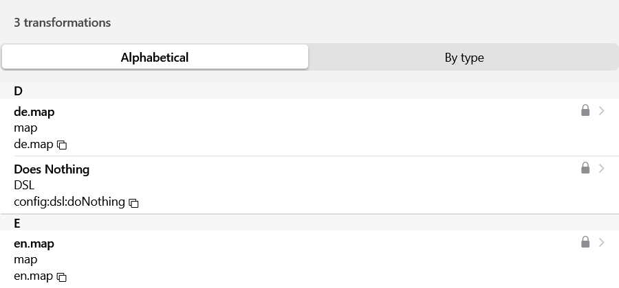

I’ve found the bug causing the retrieval of managed transformations from storage to fail, and created a PR since I hope it’s small enough for the exception:
https://github.com/openhab/openhab-core/pull/4574
If this is merged and later released, posting transformations on the marketplace should work as far as I can tell. I consider organizing how they are presented more of a “cosmetic issue”, and I’ve also suggested how that can be at least improved. I can’t create a PR for that, as the changes are “too big”, but it should be easy for anybody interested to do this.

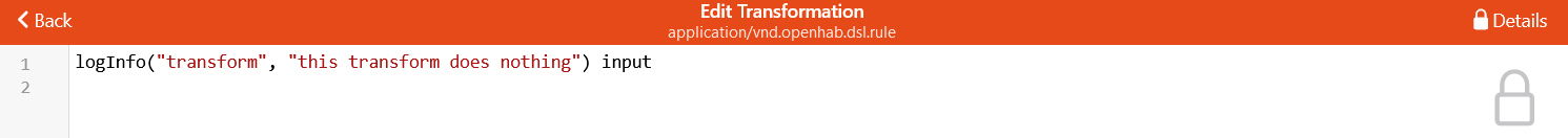

I had to remove the { } for the YAML parser to accept it, but other than that it does indeed install:
Furthermore, running this script
var test = transform("DSL", "config:dsl:doNothing", "test")
..results in this log entry:
07:09:58.026 [INFO ] [.openhab.core.model.script.transform] - this transform does nothing
All in all, I’d say that it seems like it works :slight_smile:

When thinking about your wish to have a better organization/categorization in the marketplace browser for transformations, I think this is what it boils down to, and I agree: These are different things and should be presented as such. The fact that all the official transformation entries are bundles, and most of those found on the marketplace probably won’t be, isn’t enough. They should be separated by the role they play, which is fundamentally different. The problem of course, is that “script transformations” could be argued to be something in between the two…
I found out that contentType actually is different already. “Transformations” use application/vnd.openhab.transformation, while “transformation services” use application/vnd.openhab.bundle. I’m not sure if that’s a “100% trustworthy rule”, but assuming it is, I’ve tweaked MainUI to produce this:
This is just an example to show what I’m talking about, there are multiple problems with this “implementation”:
  • I have no idea how to do layout in F7, so I didn’t even try - I just changed the size of the titles.
  • The scripting doesn’t work completely like it should, the “main sections” aren’t hidden when there are no children, as they were supposed to. I’m not sure why, but I think there is something with the scope in Vue that I haven’t quite gotten.
  • I just used the terms from Core - I’m in not way suggesting that the terms have to be “Transformation Services” and “Transformations” - but it’s the closest thing to something meaningful I have.
It could also be done “the other way around”, there “Transformation Services” and “Transformations” were the “main titles” and the sources the “sub titles”, but it would require some more restructuring of the JS/Vue stream filtering, as they are organized in different “lists” based on the source as it is today, making it easy to just filter out contentType from those lists.
Is it anything here that would be of any interest?

The closest analog for what gets posted the the transformations category on the marketplace is rule templates. They should be presented the same way.

As I said, yes, it exists on the forum, but not in the add-on store. There is no “bundle” category there. It’s by coincidence that things are “so neatly separated” as they are - many things can only be provided either as a bundle or not as a bundle - but not both. The exceptions are UI and Automation where contentType is used to differentiate them. Everything with application/vnd.openhab.uicomponent;type=widget is under “Widgets for the Main UI”, everything that doesn’t match this is lumped together under “Other UI Add-ons”. Similarly for Automation, application/vnd.openhab.ruletemplate is “Rule Template”, application/vnd.openhab.uicomponent;type=blocks is “Block Library” and everything else is “Languages & Technologies”. For Automation, community marketplace, JSON 3rd party and official add-ons are mixed in the “Languages & Technologies” category.
