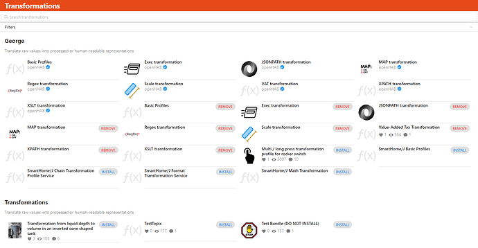

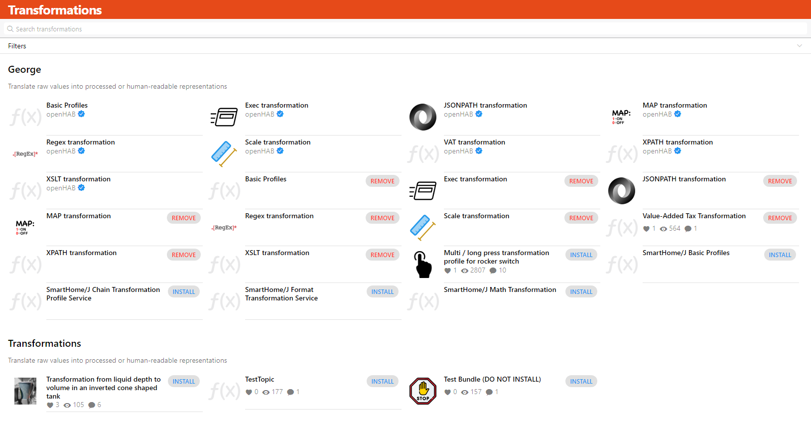

To attempt one more time to show you, here is your “George” example as I understand it:
Ingore the fact that the installed add-ons are listed twice - that has to do with the “demo app” and can be ignored.
The changes required to achieve this are very small:

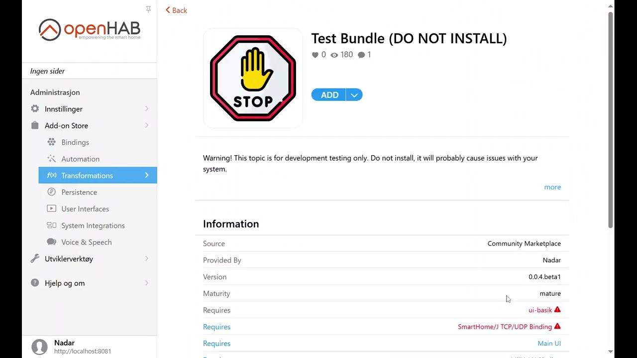

I’m working on implementing dependecies. I’m spending a lot of time to do very little with Vue/F7, so I’ve decided not to put too much in to visual part at this time, and focus on getting the functionality working. IF this ever becomes anything, I’m sure I can get some help from somebody more experienced to get the visuals right.
I’ve captured a little video to show how it currently works. I’m not quite sure what’s the “right” way to handle when a user attempts to install an add-on with a missing dependency. As of now, it just shows the dependencies and trying to install will result in a error. That’s not intended to be the final solution though.
When capturing this video, my “test add-on” was defined as this:
Version: 0.0.1
DependsOn: ui-basik, org-smarthome-binding-tcpudp, ui-ui, binding-milllan
Keywords: test, debug
Countries: ; NO, SE,
License: GPL
Connection: local
LoggerPackages: com.example.test
Documentation: https://github.com/Nadahar/Mill-LAN-openHAB-Binding/blob/master/bundles/org.openhab.binding.milllan/README.md
Issues: https://github.com/Nadahar/Mill-LAN-openHAB-Binding/issues
I realize that it will probably be very rare that an add-on depends on more than one other add-on, but for the purpose of implementing it, I must handle that too, which is why it’s in the test. Also not that one of the dependencies are invalid/non existing, which is why it has no link in the video. The red ones are those that aren’t installed.
Any feedback/suggestions are welcome.

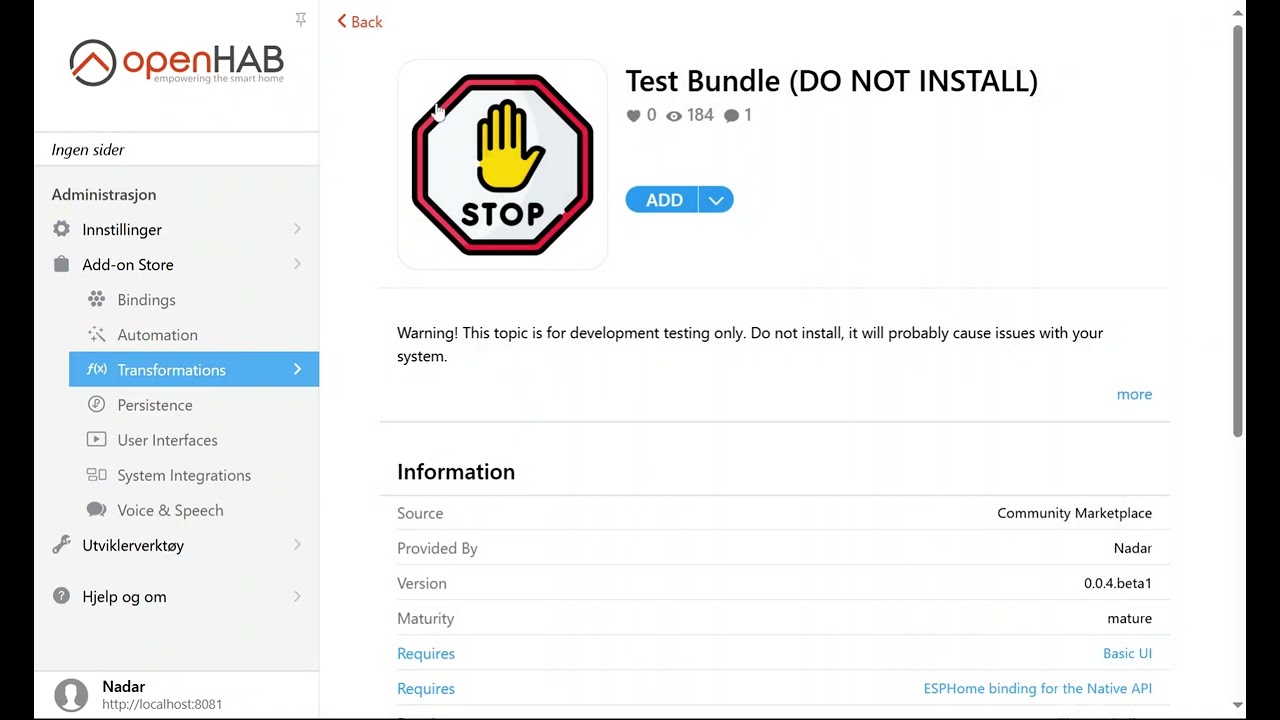

I noticed something in the log by coincidence that probably explains why it doesn’t work:
Unresolved requirement: Import-Package: org.openhab.core.automation; version="[4.3.0,5.0.0)"
You seem to have specified a version range in your pom.xml, and since latest main is now a 5.0.0-SNAPSHOT it can’t resolve the dependencies.
This also explains why it won’t work on my production installation, since it’s running 4.2.3.
edit: I added the same range restriction to the title of your marketplace entry so that it won’t show up for installations that’s outside the range, as it will never work for those with these restrictions in the POM.
I’ve implemented more of the dependecy management. I’ve opted not to install dependencies automatically, as I’m a bit hesitant of doing things where it’s not certain that the user understands that it’s being done. It could always be changed of course.
