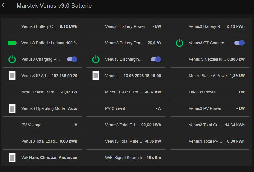

Since yesterday I have a brand new Marstek Venus E v3 and installed it instantly to see, if it works and it does. I use it as an extension to our existing SolarEdge plant with an LG storage.
Then I installed the beta version 0.1 of your binding and it was activated smoothly. I linked items to all channels and got data from several channels:
Some items keep staying empty.
Today I installed the SNAPSHOT version 5.2.0.202601091712 to see, if some more data is coming up and to try if I can update some values. I am especially interested in updating the switches for charging/discharging permitted, but they are still not updating the Venus.
Do you have a list of channels that should work? Are there already update channels provided?

Looks good to me. The items that are empty are the pv ones that are not supported by that model,no?
You can set charging mode and power as described in the readme. With this you can turn charging on and off.
