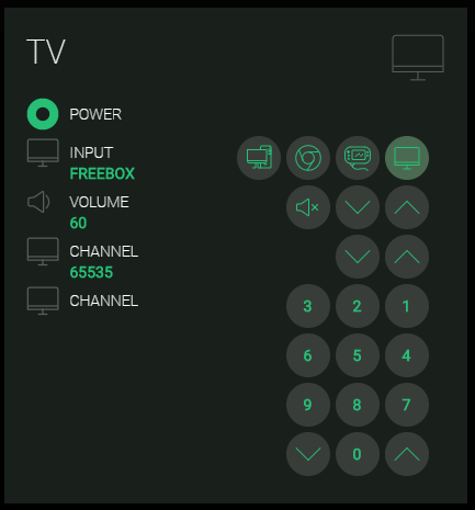

I managed to make a digipad :
I have to fix the last line using offsets in order to allow a “0” centered without anything else. Here is the code :
    <div class="widget" ng-class="{true: 'disabled'}[itemValue('YamahaReceiverRXV477_InputSource')!='HDMI1' || itemValue('gTeleAmp')=='OFF']">

this looks cool!
All the buttons are wired up to “channel up”, so I don’t understand how it works …
It was just a test code, I didn’t implemented function behind yet.

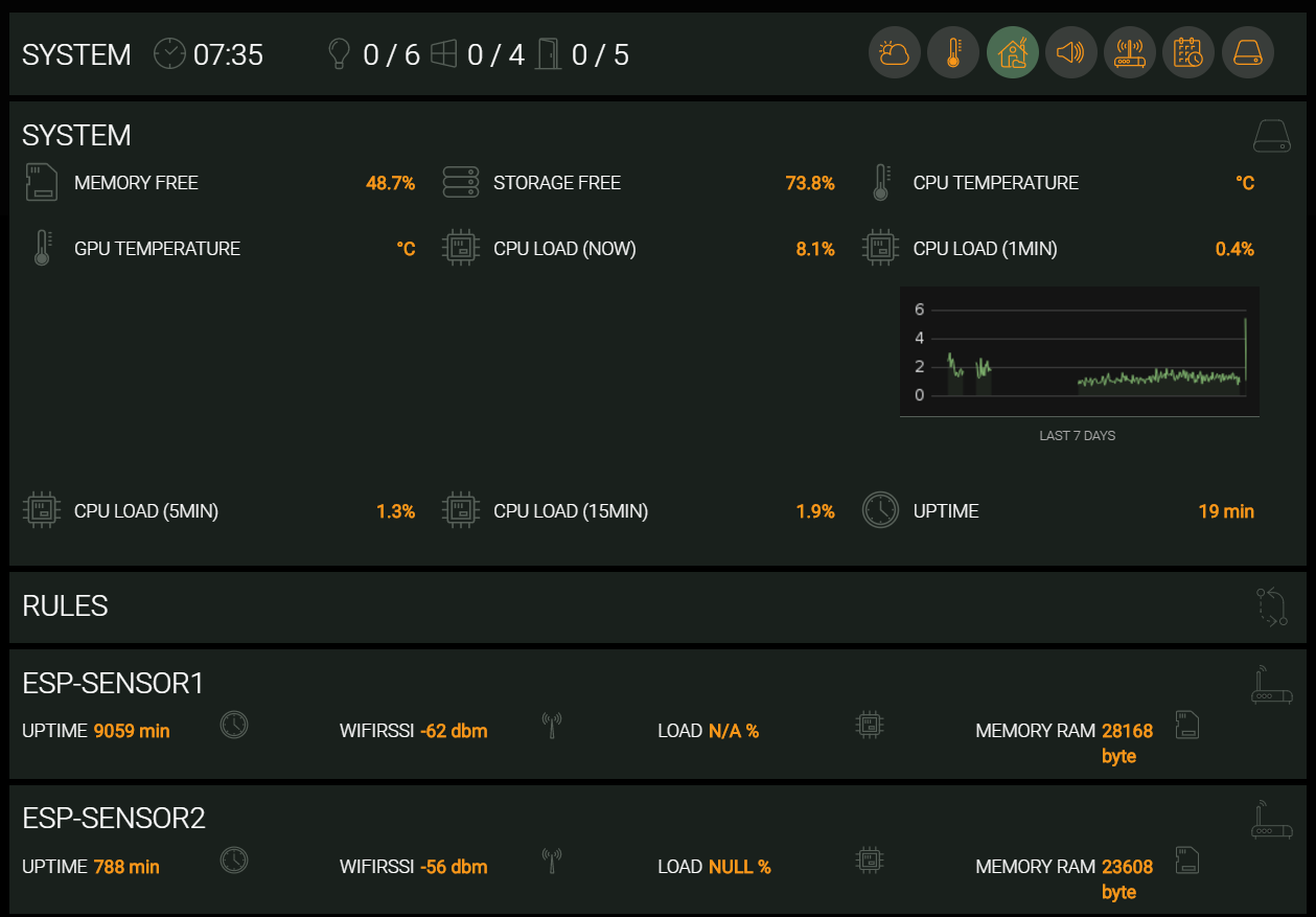

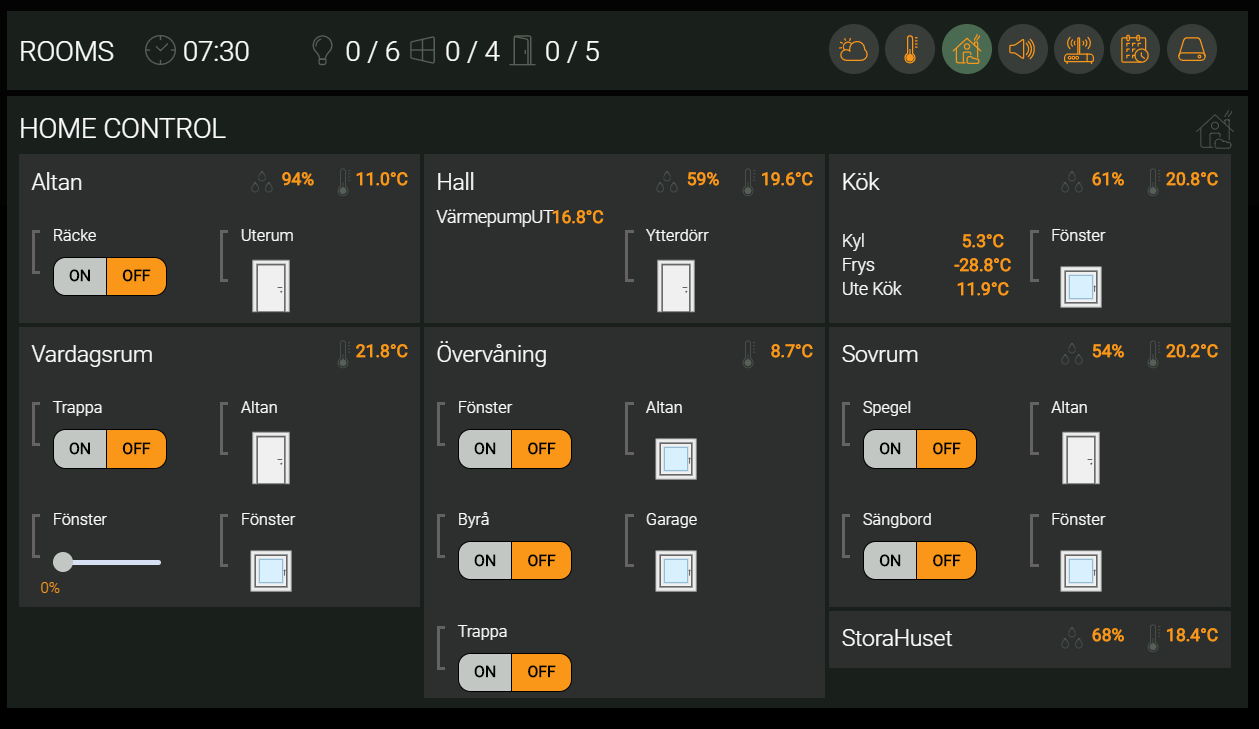

Here are some screenshots of my panel. There are still some work to be done. I just bought a NetAtmo Weather station and a WelcomeHome Camera that needs to be implemented :slight_smile:
I need to tweak the thermostat control, it looks terrible right now. I needed it up fast since I have this installation at my summerhouse and need to turn on the heating remote when I plan to go there (Getting cold in Sweden)
roommusiccalendarespsystemwifiweather

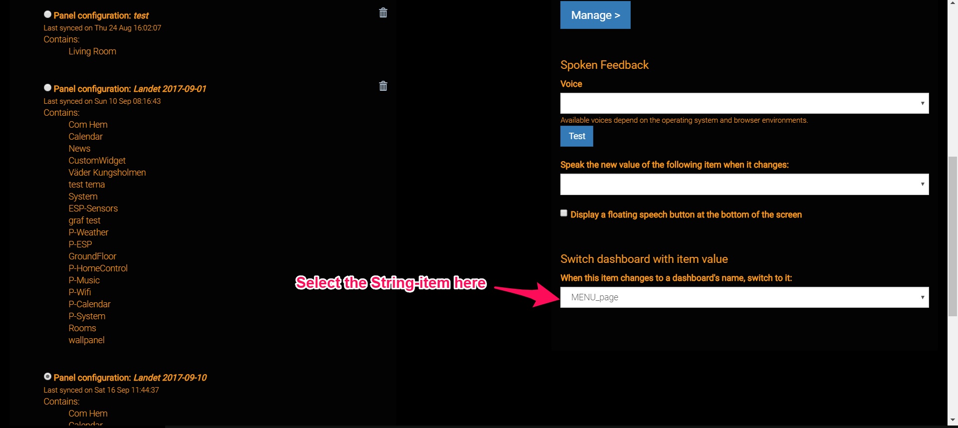

Yes I use them to navigate, create a custom String-item to save the navigation
The first section is the clock (NTP), and 3 group items to show number of lights, windows, doors open.and then the navigation.
You can remove the “?kiosk” if you don’t want it to run in full-screen.
