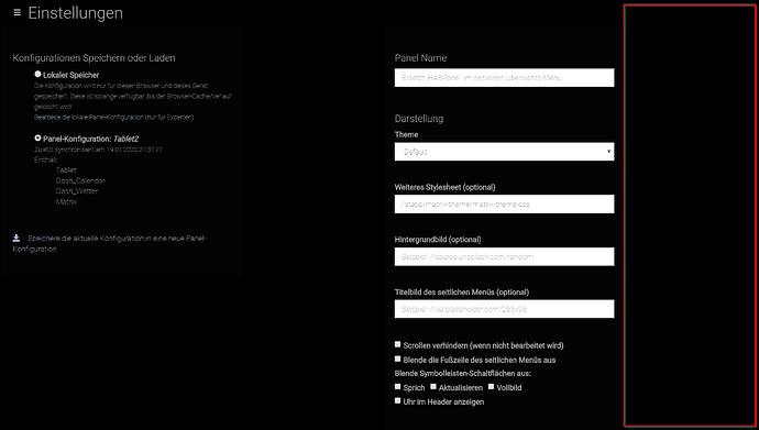

everytime when I’m switching to the matrix-them stylesheet in my habpanel configuration the screen width will be adjusted. It also has an impact on the widget width itself (see red marked area). Could you please help me to find the error.

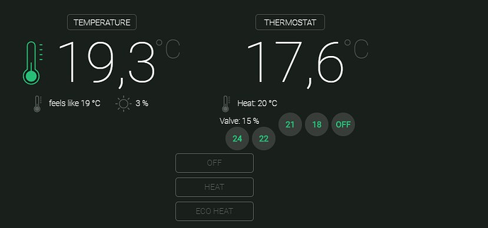

Yes I am not the .json programmer and I do my best to improve but since couple of days I struggle with three problems:
  1. I can not get icon ā€œheaterā€ displayed on thermostat section.
  2. I can not get the scene buttons, temp. set buttons and valve value aligned with the rest of the content.
  3. Active scene is not highlighted
Can someone look at this and help me to find the solution?
All icons saved in the /static/matrix-theme/squidink.svg are displayed properly only ā€œheaterā€ can not. I tried many tricks but gave up.
This is Part of the squidink.svg file referring to the heater icon:

Ref2. Scene buttons and value circles shall be matching the section’s width and highlighted being active
My widget:
<div class="section">
	<div class="bigDash">
		<div class="description">Temperature</div>
		<div class="top">
			<div class="icon on"><svg viewBox="0 0 48 48"><use xlink:href="/static/matrix-theme/squidink.svg#thermometer-3"></use></svg></div>
			<div class="value">
				<div class="main">{{itemValue('BS_Office_Temperature') | number:1}}</div>
				<div class="sub">&#176C</div>
			</div>
		</div>
		<div class="bottom">
			<div class="icon off"><svg viewBox="0 0 48 48"><use xlink:href="/static/matrix-theme/squidink.svg#thermometer-3"></use></svg></div>
			<div class="value">feels like {{itemValue('BS_Office_Temperature') | number:0}} &#176C</div>
			<div class="icon off"><svg viewBox="0 0 48 48"><use xlink:href="/static/matrix-theme/squidink.svg#sun"></use></svg></div>
			<div class="value">{{itemValue('BS_Office_Luminance') | number:0}} %</div>
		</div>
	</div>
		<div class="description">Thermostat</div>
		<div class="top">
			<div class="icon on"><svg viewBox="0 0 48 48"><use xlink:href="/static/matrix-theme/squidink.svg#heater"></use></svg></div>
			<div class="value">
				<div class="main">{{itemValue('BS_Office_Thermostat_Temp') | number:1}}</div>
			</div>
		</div>
			<div class="value">Heat: {{itemValue('BS_Office_Thermostat_SetpointHeat') | number:0}} &#176C</div>
			<div class="icon off"><svg viewBox="0 0 48 48"><use xlink:href="/static/matrix-theme/squidink.svg#heater"></use></svg></div>
			<div class="value">Valve: {{itemValue('BS_Office_Thermostat_Valve') | number:0}} %</div>
     	<div class="controlGroup">
       	<div class="control">OFF</div>
        <div class="control">18</div>
				<div class="control">21</div>
				<div class="control">22</div>
				<div class="control">24</div>
     	</div>
     	<div class="widget">
   	  	<div class="sceneGroup">
					<div class="scene" ng-click="sendCmd('BS_Office_Thermostat_Mode', '0')">OFF</div>
       		<div class="scene" ng-click="sendCmd('BS_Office_Thermostat_Mode', '1')">HEAT</div>
       		<div class="scene" ng-click="sendCmd('BS_Office_Thermostat_Mode', '11')">Eco HEAT</div>
     		</div>
   		</div>
    </div>
 </div>
</div>

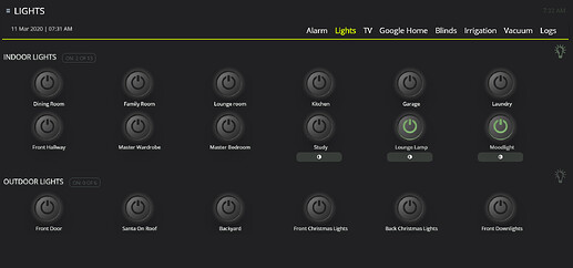

Hi.
I am trying to make my icons dynamic. in this example its working like expected
But now i want to make this with group(glights) that is filtered . is this possible? can the ng-if check the value of item in the group? and if yes how is the syntax?
<div class="widgetMenu2">
				<div class="icon on" ng-if="itemValue('GenericMQTTThing_SonofLamp')=='ON'">
          <svg viewBox="0 0 48 48"><use xlink:href="/static/matrix-theme/matrixicons.svg#light_bulb"></use></svg></div>
        <div class="icon off" ng-if="itemValue('GenericMQTTThing_SonofLamp')=='OFF'">
				<div class="name">{{(itemsInGroup('glights') | filter:{state:'On'}).length}} of  {{(itemsInGroup('glights')).length}}</div>
			</div>```

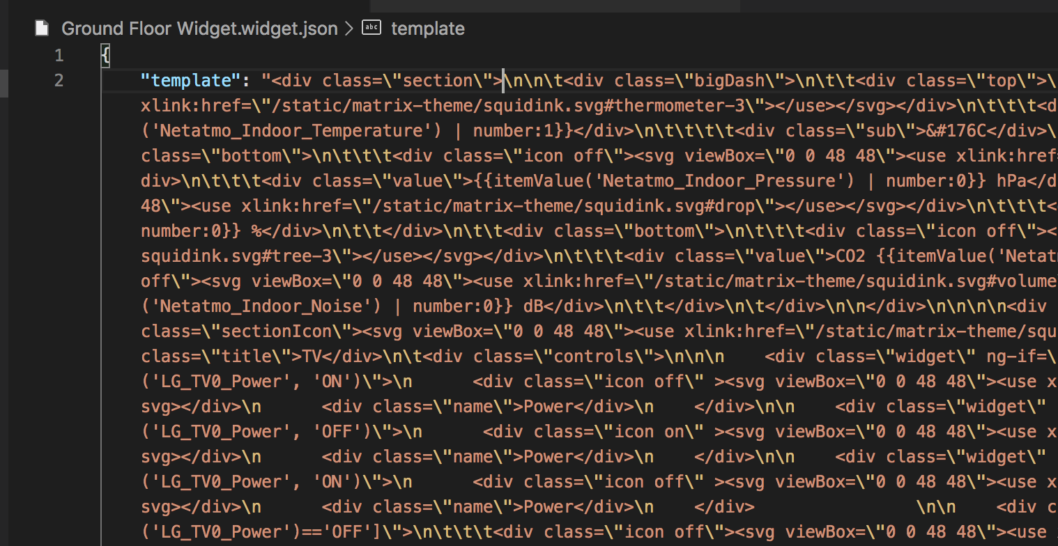

Based of what I understand of the CSS, you’re looping over all items of a group to display its status and to enable switching.
<div ng-repeat=\"item in itemsInGroup('gGroundFloorLights').concat(itemsInGroup('gGroundFloorHue')) | filter:query as filtered\">
What if you have multiple groups (e.g. gBasement, gFirstFloor, fSecondFloor)? I suppose I have to copy everything 3 times and modify each loop. Is this correct? In order to avoid this, I’ve created a string in the widget that I want to use as loop. But this isn’t working. Any help?
<div ng-repeat=\"item in itemsInGroup('{itemValue(config.group_name)}') | filter:query as filtered\">

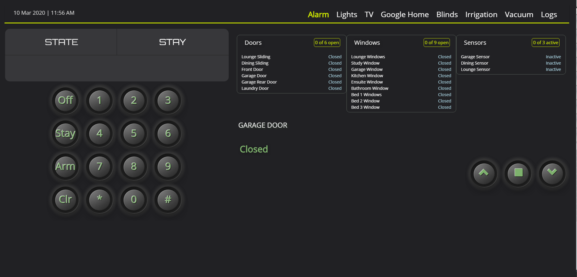

Sorry mate for the late reply.
I have this code in every page. I have a template on each page. and i place all sections. widgets and buttons into the one template.
I have this part of the code at the beginning of the template.
<style>
.section .widget{
  padding:5px 0px 5px 0px;
  margin:2px 0px 2px 0px;
@media screen and (max-width: 750px) {
#AlarmSection, #ZoneSection{
  width:100%;
.collapsible-menu label {
  visibility: visible;
  font-size: 30px;
  display: block;
  cursor: pointer;
 .menu-content {
  	max-height: 0;
    overflow: hidden;
  margin-right: 35px;
ul li2 {
  display:block;
  float: none;
  ul li3 {
  visibility: hidden;
  display:none;
</style>
 <div class="collapsible-menu">
   <input type="checkbox" id="menu"><label for="menu">{{ngModel.name}}</label></input>
         <div class="menu-content"><li3>{{itemValue('Date') | date:'d MMM yyyy | HH:mm a'}}</li3>
  <ul>
  <li2><a2 ng-class="{true: 'selected'}[ngModel.name=='Alarm']" ng-click="sendCmd('HomePageItem', 'Home?kiosk=on')" >Alarm</a2></li2>
  <li2><a2 ng-class="{true: 'selected'}[ngModel.name=='Lights']" ng-click="sendCmd('HomePageItem', 'Lights?kiosk=on')" >Lights</a2></li2>
  <li2><a2 ng-class="{true: 'selected'}[ngModel.name=='TV']" ng-click="sendCmd('HomePageItem', 'Tv?kiosk=on')" >TV</a2></li2>
  <li2><a2 ng-class="{true: 'selected'}[ngModel.name=='Google Home']" ng-click="sendCmd('HomePageItem', 'Chromecast?kiosk=on')" >Google Home</a2></li2>
  <li2><a2 ng-class="{true: 'selected'}[ngModel.name=='Blinds']" ng-click="sendCmd('HomePageItem', 'Blinds?kiosk=on')" >Blinds</a2></li2>
 	<li2><a2 ng-class="{true: 'selected'}[ngModel.name=='Irrigation']" ng-click="sendCmd('HomePageItem', 'Irrigation?kiosk=on')" >Irrigation</a2></li2>
  <li2><a2 ng-class="{true: 'selected'}[ngModel.name=='Vacuum']" ng-click="sendCmd('HomePageItem', 'Vacuum?kiosk=on')" >Vacuum</a2></li2>
  <li2><a2 ng-class="{true: 'selected'}[ngModel.name=='Logs']" ng-click="sendCmd('HomePageItem', 'Logs?kiosk=on')" >Logs</a2></li2>
</ul>
</div>
</div>
</div>
I then have an item called HomePageItem that is updated with the page view. And in habpanel, i have it set to look at HomePageItem and go to that page when it is updated.
The page names is what is shown at the end of the URL when you are on the page you want. So for instance, you would change this part Vacuum?kiosk=on to whatever your page is called. kiosk=on will remove the menu bar and page name up the top on each page. I do this because i have the Menu being highlighted depending on the page name that is active. You can remove the Kiosk=on or change it to Kiosk=off if you wanted to keep the menus.
So for instance. This is my entire code for my Alarm Page

I wanted to have a look at the theme and downloaded all files from git, but when trying to have a look at one of the json-files in VS-Code it’s totally unreadable with all CR/LF and Tab presented as \n and \t. Any ideas on how to remedy this?
After investigating a bit further I realized you aren’t supposed to manage the json-files in VS Code. Instead you load the widget into HabPanel and edit it there :upside_down_face:
