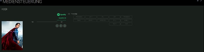

i try to change my arrangement, but somehow i can’t.
I would like that as you can see in the picture that everything comes down to the right of the cover.
and next to the list of channels I would like to have the same again.
can someone help?
<div class="sectionIconContainer"><div class="sectionIcon"><svg viewBox="0 0 48 48"><use xlink:href="/static/matrix-theme/squidink.svg#sound2"></use></svg></div></div>
<div class="title">Kodi</div>
<div class="controls">
	<div class="widget">
		<div class="valueGroup">
			<div class="value">{{itemValue('Alexaechodot2_Title')}}</div>
			<div class="value">{{itemValue('Alexaechodot2_musikanbieter')}}</div>
		</div>
		<div class="movie">
			<div class="cover" ng-style="{'background-image': 'url(' + itemValue('mykodi_thumb_office') + ')'}"></div>
			<div class="playback">
				<div class="playbackTime">{{ itemValue('Alexaechodot2_progresstime')}}</div>
				<div class="playbackBar"><div class="playbackBarDone" ng-style="{'width': itemValue('spotify_current_progress_percent') + '%'}"></div></div>
				<div class="playbackTime">{{itemValue('Alexaechodot2_duration')}}</div>
			</div>
			<div class="controlGroup">
      	<div class="control" ng-click="sendCmd('Alexaechodot2_player', 'NEXT')"><svg viewBox="0 0 80 80"><use xlink:href="/static/matrix-theme/squidink.svg#right-arrow-3"></use></svg></div>
					<div class="control" ng-click="sendCmd('Alexaechodot2_player', 'PLAY')" ><svg viewBox="0 0 80 80"><use xlink:href="/static/matrix-theme/squidink.svg#right-play"></use></svg></div>
        <div class="control" ng-click="sendCmd('Alexaechodot2_player', 'PREVIOUS')"><svg viewBox="0 0 80 80"><use xlink:href="/static/matrix-theme/squidink.svg#left-arrow-3"></use></svg></div>
			</div>
		</div>
</div>
		<div class="icon off"><svg viewBox="0 0 48 48"><use xlink:href="/static/matrix-theme/squidink.svg#line-visuals"></use></svg></div>
		<div class="name">TV Kanäle</div>
		<div class="sceneGroup">
			<div class="scene" ng-click="sendCmd('daserste', 'ON')">Prosieben</div>
			<div class="scene" ng-click="sendCmd('zdf', 'ON')">ZDF</div>
    <div class="scene" ng-click="sendCmd('rtl', 'ON')">RTL</div>
			<div class="scene" ng-click="sendCmd('sat1', 'ON')">SAT 1</div>
    <div class="scene" ng-click="sendCmd('prosieben', 'ON')">ProSieben</div>
			<div class="scene" ng-click="sendCmd('kabel1', 'ON')">Kabel 1</div>
    <div class="scene" ng-click="sendCmd('rtl2', 'ON')">RTL 2</div>
			<div class="scene" ng-click="sendCmd('superrtl', 'ON')">SUPER RTL</div>
    <div class="scene" ng-click="sendCmd('sport1', 'ON')">SPORT 1</div>
    <div class="scene" ng-click="sendCmd('dmax', 'ON')">DMAX</div>
    <div class="scene" ng-click="sendCmd('sixx', 'ON')">SIXX</div>
     <div class="scene" ng-click="sendCmd('tele5', 'ON')">TELE 5</div>
 	</div>
</div>
