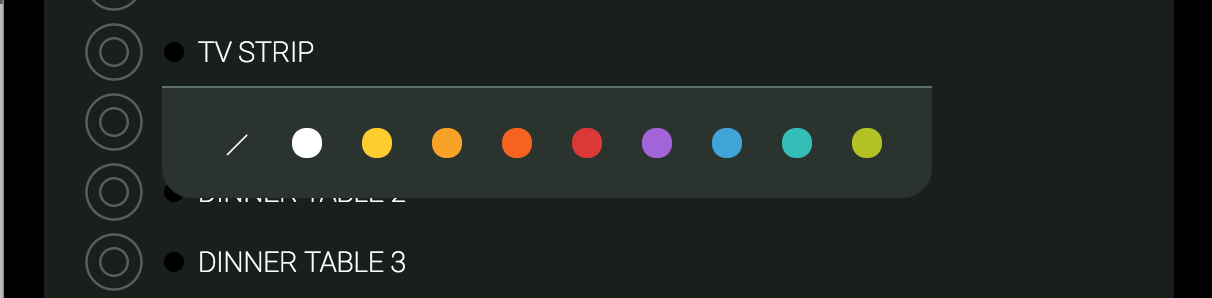

  • Added “Color Light” control for lights (found in the ground floor widget):

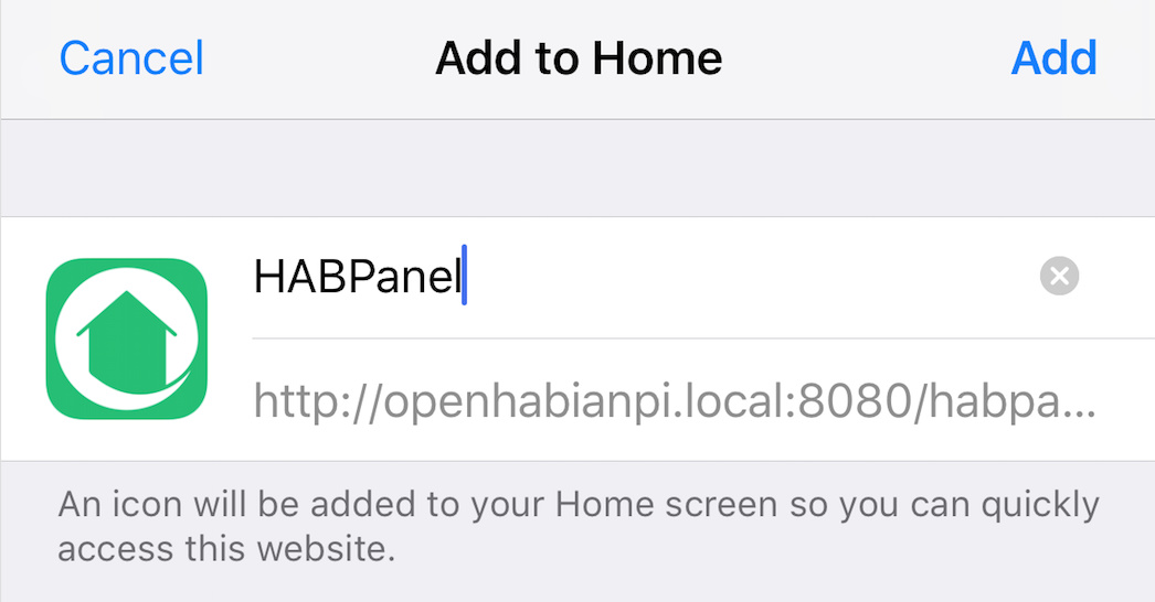

  • Added my own icon as “Apple Touch Icon” for saving HabPanel to the iPhone/iPad home screen:
Enjoy :slight_smile:

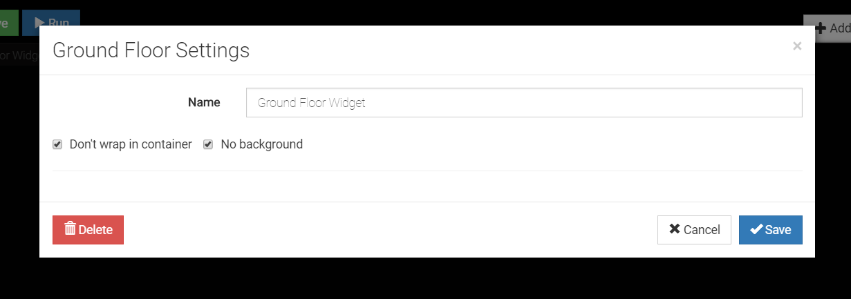

I’m really new to the software side of things, so setting up OpenHAB hasn’t been easy as I’m learning Linux and everything from scratch. But I’ve managed to install your Matrix theme and gotten to the point of adding widgets. The widget displays when ‘run’ but perhaps I’m missing something that isn’t allowing me to edit the widget?
This is what I see:
Image 2

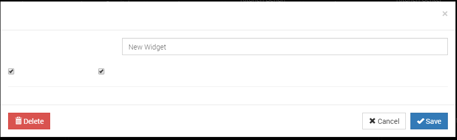

Other widgets if I make them myself, I see:
Image 3Image 4
Ah, it’s 3am. I’m gonna call it a night and try again tomorrow!
Oops, I missed those two files. I uploaded them now! Thanks for pointing it out!
Hi @canuckcam, the widgets are “templates” (as in you need to make it your own and edit the details) but delivered as custom widgets (json).
You have two options to edit them:
  1. Click on the cogwheel in the custom widget management section, then click on the widget and edit the markup there.
  2. Create a new “template” widget and copy the markup from the custom widget.
In the markup, you need to look at the item names, group names, labels, etc. to customise it to your needs.
Unfortunately, I didn’t have the time yet to add configuration options as suggested by some here. When I get some time, I’ll try to do that, but for now they are just starting points that you need to make your own by editing the markup.
