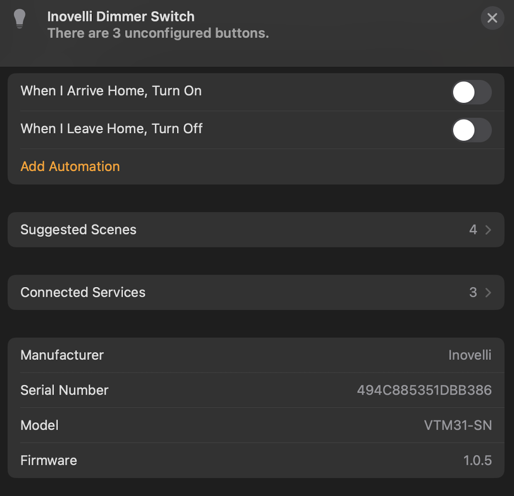

I couldn’t find a way to check which fabrics the device is connected to, is it in Apple’s Home App?

Look for “connected services”, also i think you have to be inside your network to have this show up, if you are outside your lan, i think its not available (like accessing on the road).
Ok, thanks! Interestingly I don’t have the “Connected Services” - anyways I also tried to reset the device and set it up from scratch without luck. I guess either something wrong with the device or my network doesn’t allow it. For now I think I will just use Homekit for automations.

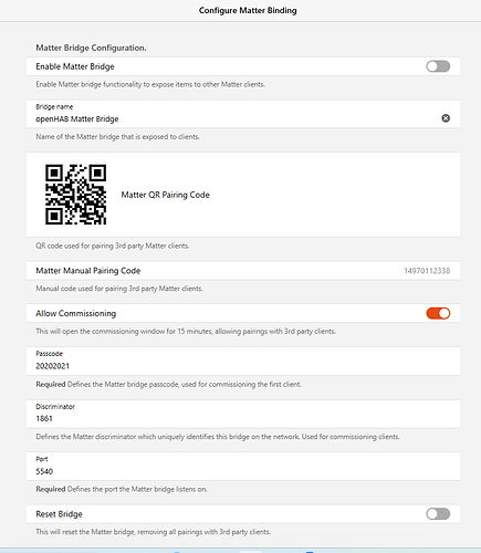

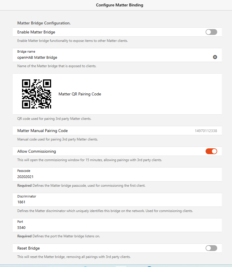

I updated post after setting the log level in the console. Here is my config page
Thanks for the AI summary, but i would need to see the log to understand the issue, if you could PM that to me that would be helpful
