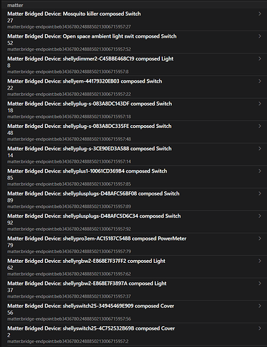

Only this time with the new version all of the shellys popped up o.O
Actually.. I’m counting 17 shellys.. I have 14.. anyway… “Deserialize” didn’t pop up either. Idisabled and reenabled the thing a couple of times.
I’m wondering if maybe the previous jar I had wasn’t the most up to date…? could that explain it?
edit:
Yep, devices are found, I can add them, only the channels are missing, I guess the previous logs are what will enable the channels.
But yeah, everything seems to have worked out now.
Edit2:
Okay, confirmed I was running an out of date version of the binding. All of my previous matter devices broke. I remember you mentioning you had changed the logic of the clusters I believe, some days ago. That’s about the last time I updated the jar. Hindsight is 20/20.
