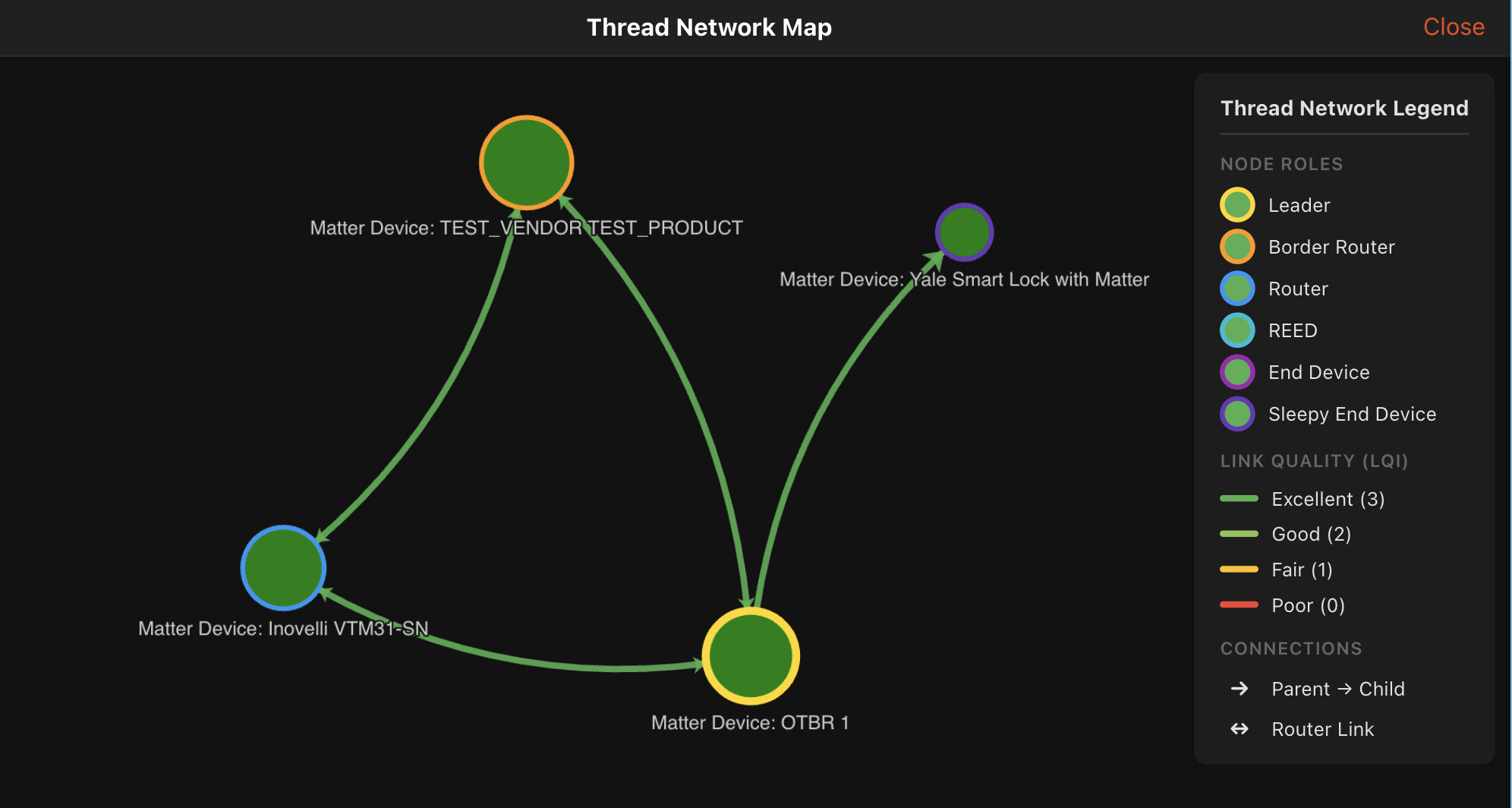

Regarding thread, this is kinda fun, but I also have a PR up in the MainUI to visualize a thread network, which is really geared towards running TBR that support Matter 1.4 ( not to be confused with Thread 1.4, Matter1.4 != Thread1.4 here), I have a few tweaks i’ll push up this weekend for managing OTBRs a bit easier too.
The setup below has 2 OTBR managed by openHAB , one is the Leader, the other acts as a Router, but if the Leader dies, it would automatically take over, pretty cool. You can see my Sleepy (read battery) device connects to just the Leader for power reasons, but the Inovelli light switch connects to both for redundancy (and also acts as router for messages if a thread device could not connect to a TBR)

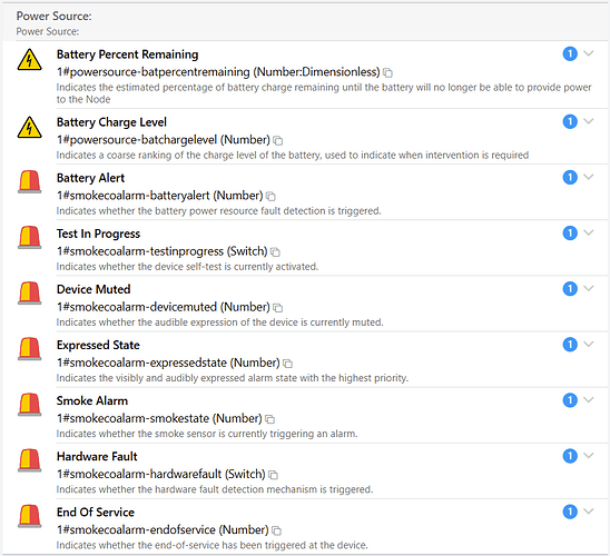

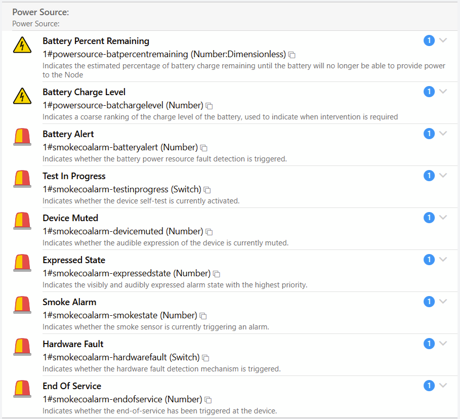

See [matter] Add Smoke, CO and CO2 client device support by digitaldan Ā· Pull Request #19897 Ā· openhab/openhab-addons Ā· GitHub
Thanks for your effort to support Smoke CO Alram device types. For my HS1SA-M smoke sensor the addtional channels got now detected.

@Lolodomo : So far I was only able to execute a manual alarm by pressing the button on the device. This action was reported by a state change of the Test in Progress channel. To test the Smoke Alarm channel I have first to order a test spray.
@digitaldan : I see in the screen capture that the channel ā€œSmoke Alarmā€ is of type ā€œNumberā€. What means this number ? I was imagined more something binary, alarm or not.
