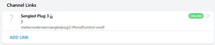

One final question for now - and it is a really minor point - in the gui - the item shows with question marks against device type. Is this expected also?
I probably need to look at the metadata associated with that channel (tags in the channel xml definition) , they may not be right, but it won’t affect functionality, just what icon is displayed by default.
