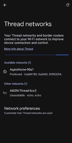

Here’s my Thread network per Android phone typing in the settings area “thread” and letting it find everything.
As you can see, I’m not seeing OH’s thread entry and you were the first setup for Matter on the network. I do see OH thread entry on Aqara’s hub so it does exist.
I merged IKEA’s Matter network onto Aqara’s hub per the video I posted on a separate thread.
I’m using Aqara M300 Hub as primary OTBR.
I tried to get my 2 Echo’s to merge onto Aqara matter network w/o luck. Lots of people having issues doing this, Alexa wants its own Thread network (ugh).
I do tag a bunch of items (using a file) to have Alexa see my dummy switches in as Matter switches which is working.
I would think that we could tell OH what thread network to use?

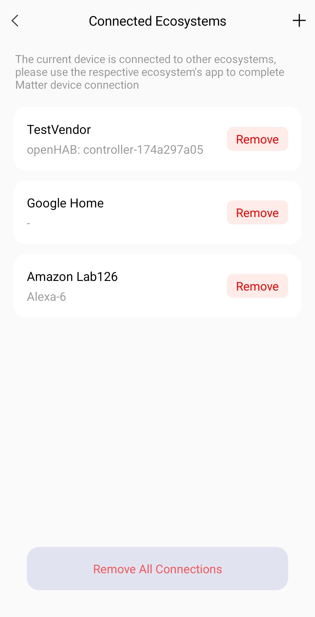

The version is 5.2.0.202603160407.
I first paired it using the Alexa app and then added it to OH using the pairing code from the Alexa app.
I’m using an ESP thread border router flashed using the image on your website.
“often retrieve the list of connected matter fabrics” - I’m referring to the thing action in OH which allows you to list the connected matter fabrics/controllers the device is connected to (sorry away from my PC and don’t remember the exact terminology).
