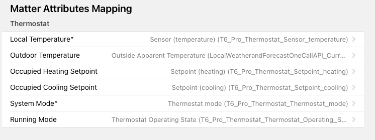

Couple thermostat questions
Will Humidity be added?

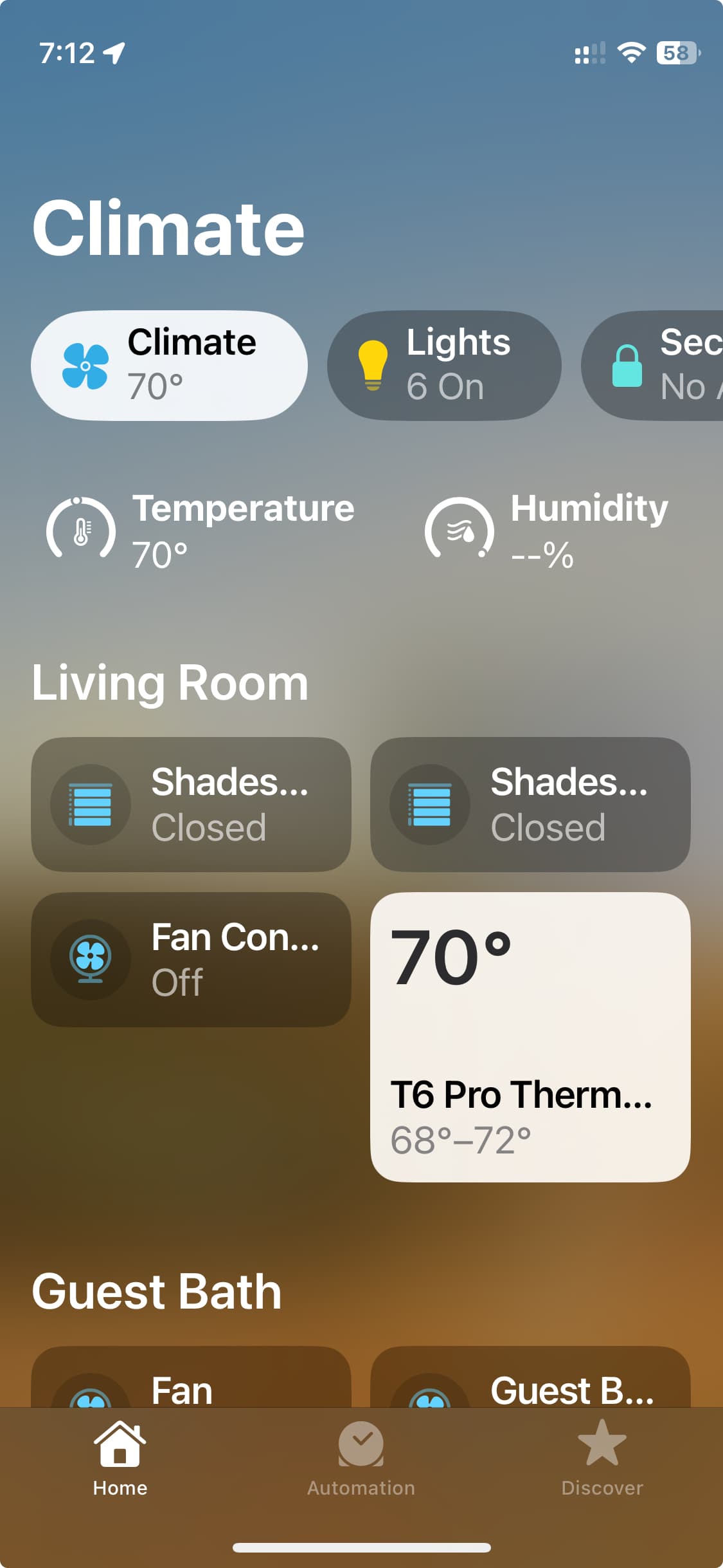

Screenshot 2025-06-27 at 7.01.45 AM

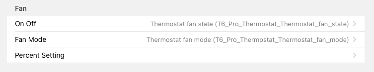

Fan is not showing up in Apple Home

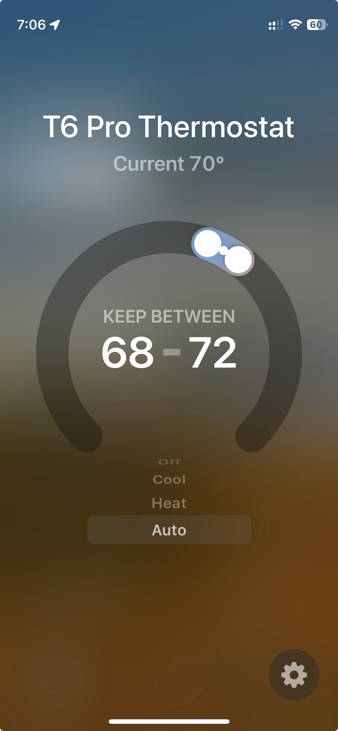

My Thermostat also has Away/Home/Sleep schedules
I’d like to add that to show up in Apple Home as read only
@Lolodomo Thanks for the suggestion. I will try it just to validate that things are working as they are intended, but this will create some other issues for me for which I will need to develop a work around. I need a pure number to interface with some other control systems, so I will have to create additional proxy items if this turns out to be the only solution. Interestingly, when I use the OH Home Kit Integration I do not have this problem. So perhaps there is a something that could be done in the Matter Binding to make it more robust.
Good catch, yeah i need to add humidity and fan control to the Thermostat bridge (and possibly others). I’ll look at that this week.

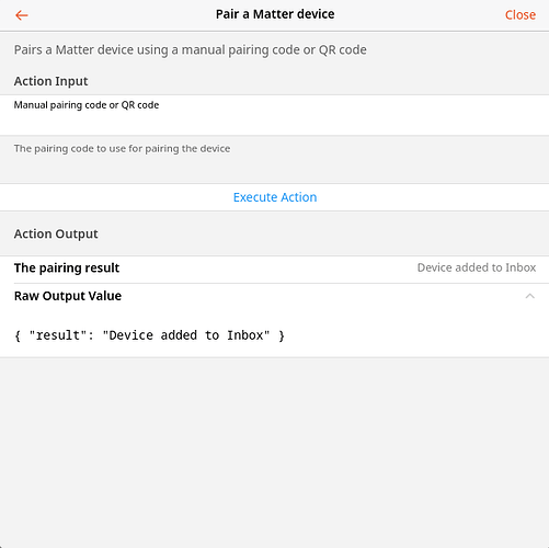

For those of you who haven’t figured it out yet, I’ve posted a How To on getting the Matter binding running within a Docker container on a Synology DiskStation: How To: Implementing Matter with Docker (or Container Manager) on a Synology Disk Station
I’m sorry, I couldn’t find the procedure. I have two questions:
