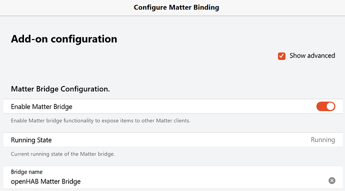

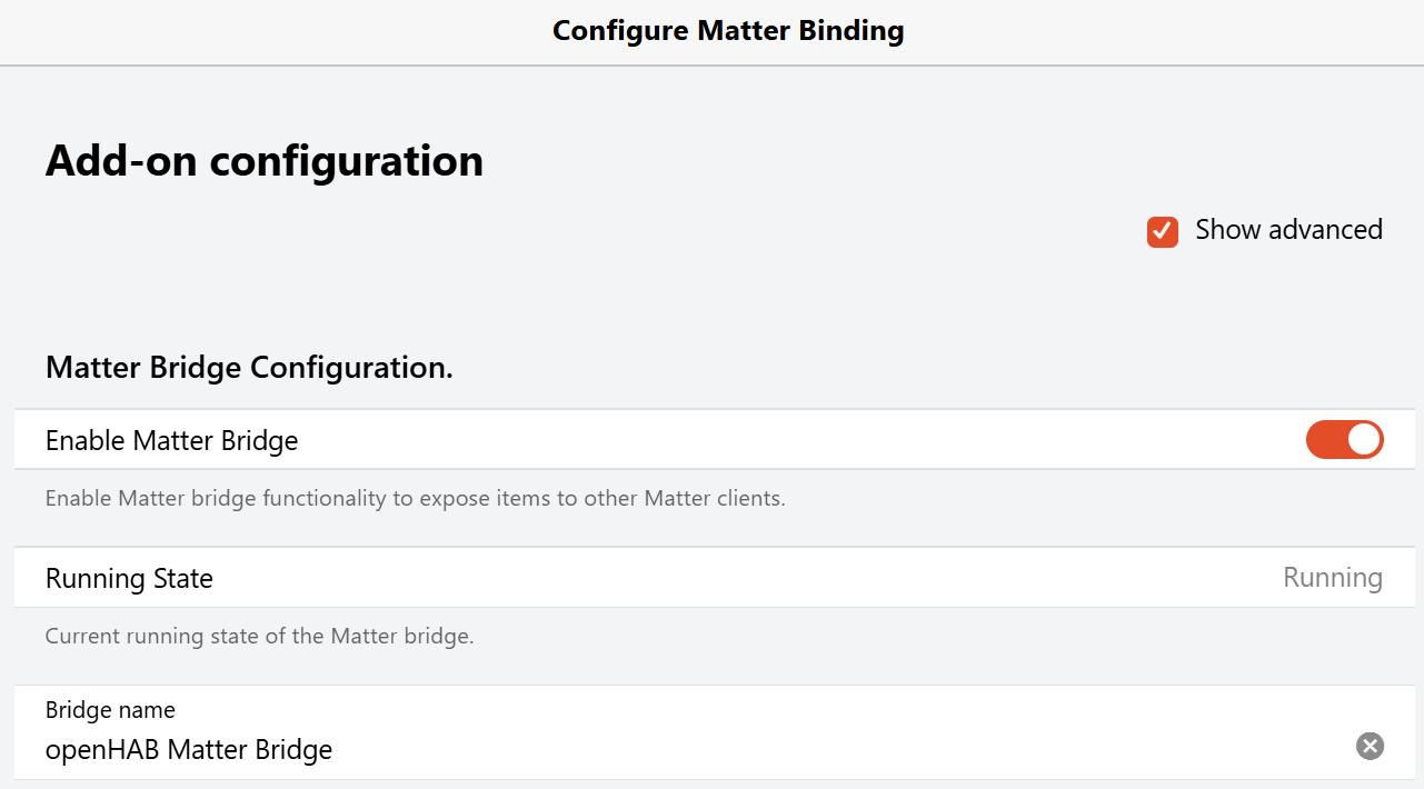

Is it possible to visualize if the matter bridge is synchronized with Alexa, similar to a watchdog function? Is the running state as in the binding configuration representative for an “active” sychronisation?
No, bridges just send state updates, they have no concept of what a client state may be. Running means the bridge has validated all the exposed items and is up and advertising itself on the network for clients. If you modify an item thats exposed via the bridge, the server will reload, so that will change to “starting” or something as its validates the exposed item(s) and and if successful, starts the matter bridge again. Matter clients will see the bridge shutting down, and then will be notified when its back up via MDNS (running), and will do a quick resubscribe to state updates (resumption in Matter speak).
Understood, thanks for explanation. I could restart the binding by a cron rule. Can the bridge be restarted alone without restarting the binding?
Why would you ever restart the binding? I don’t understand what problem thats solving. Alexa FYI has many, many matter bugs, it often claims devices are offline, but actually are not, its the weakest of the big 3 (Apple, Amazon, Google) in this regard, also too many devices expose (say more then 20 or 30) can cause memory issue in the Echos which constantly restart their connection, and can cause devices to be removed and added in the alexa app (very annoying). They were suppose to have a fix months ago, but afaik, thats not rolled out yet.
