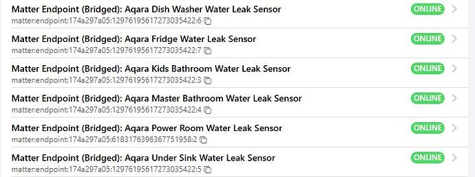

Noticed a pattern, I have a bunch of Aqara Water Sensors (generation 1). They are connected to the Aqara M3 Hub and shared with OH 5.1.3 and Matter 5.3 binding, see below.
  • serialNumber 158d008c78273e
  • vendor Aqara
  • firmwareVersion 6
  • modelId Aqara Water Leak Sensor
  • hardwareVersion 2

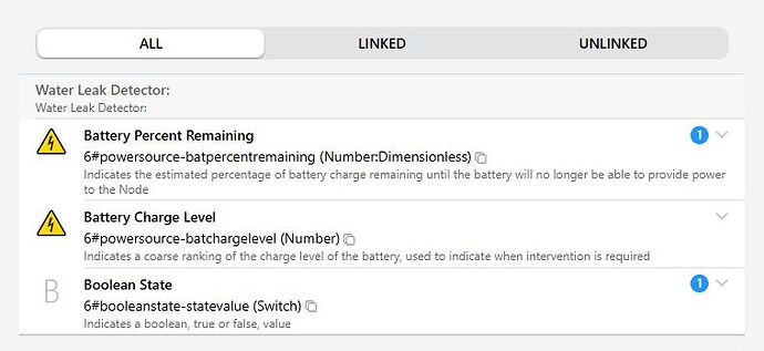

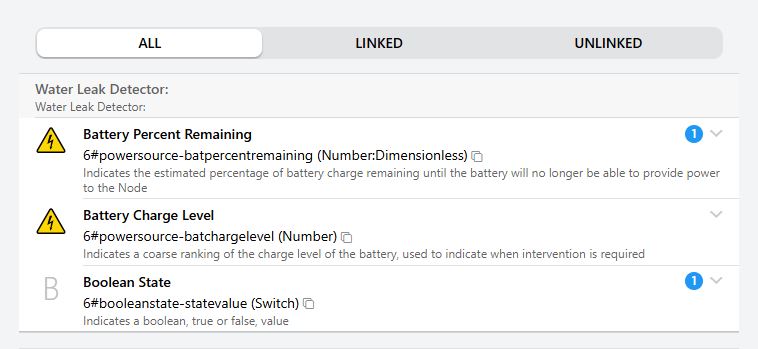

They are NOT updating via Matter UNLESS I run an open discovery scan on the Matter network, then they update. All I’m getting from them is 2 pieces of information below.
Battery and Leak Detected. I have a rule to update a virtual date item for last reported in based on battery reporting in. This is only working when I scan the matter network.
As a work around, maybe I can have the karaf syntax to initiate a matter scan maybe daily until this gets resolved?
Best, Jay
