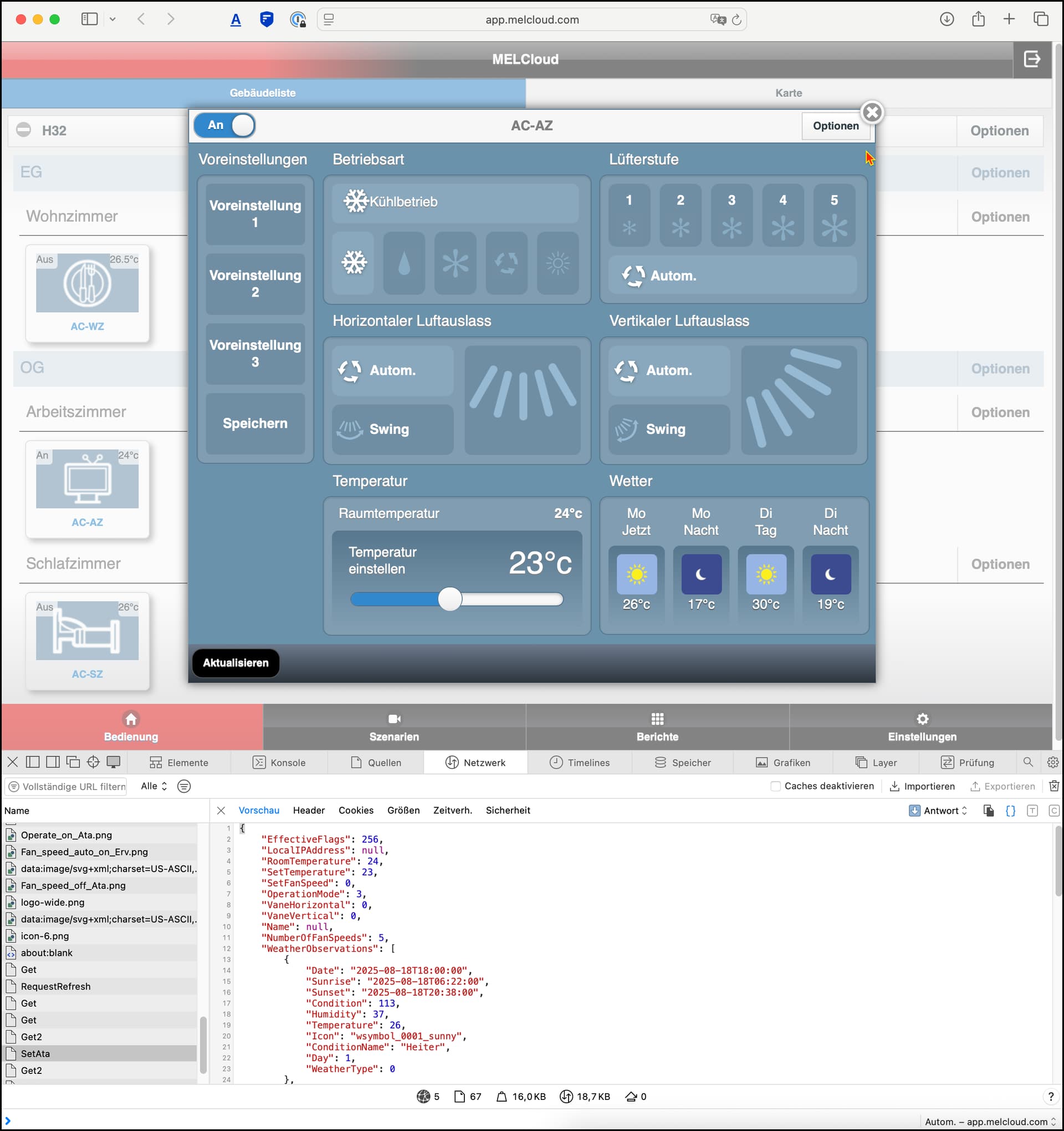

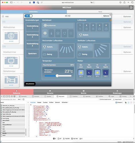

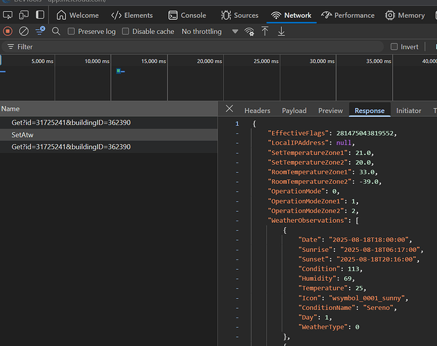

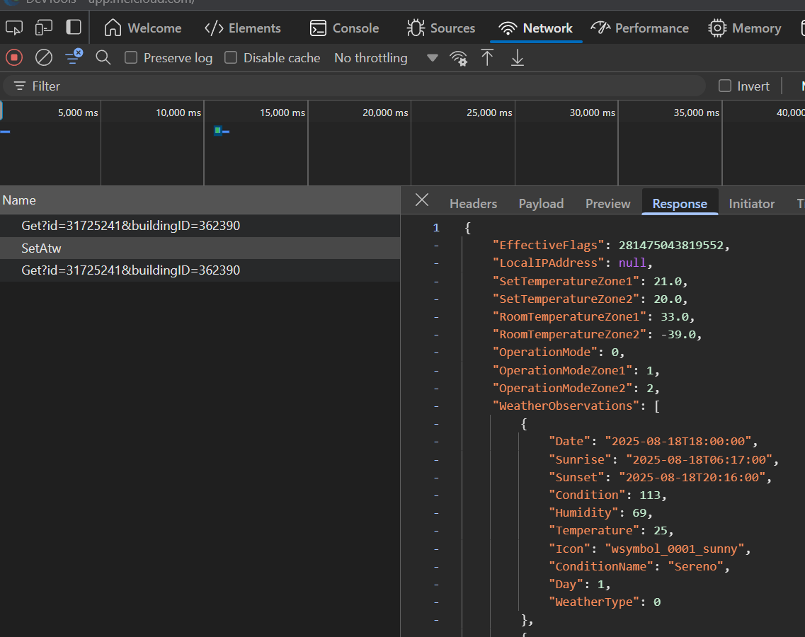

About the Wide vane thing, did you confirm that it can be done also with the melcloud app (app.melcloud.com)?
If it is the case, can you open the browser dev tools in the network tab and try to change the parameter? this should show you something like SetAta on the left column and the data exchanged with the server. Of course, this is a bit tricky cause i have no AtA devices…
Thanks for guiding me to the parameters - that’s interesting :slightly_smiling_face:
The “direction” as shown on the remote does not exist on app.melcoud.com. That would explain why we cannot control it via openHAB.
I searched for “direction” but it is not available.
Yes, it help :smiley: do you think we can go on on a 1 to 1 conversation? I think the reverse eng can be tedious for all the other users…
sure, np.
