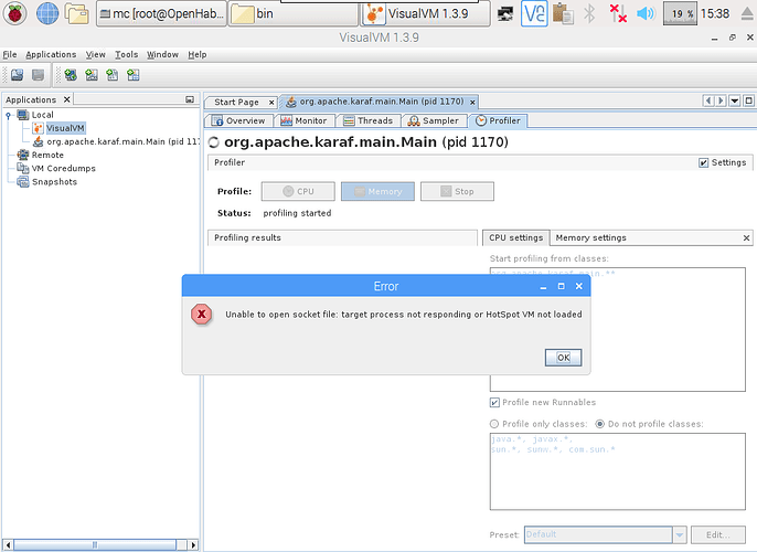

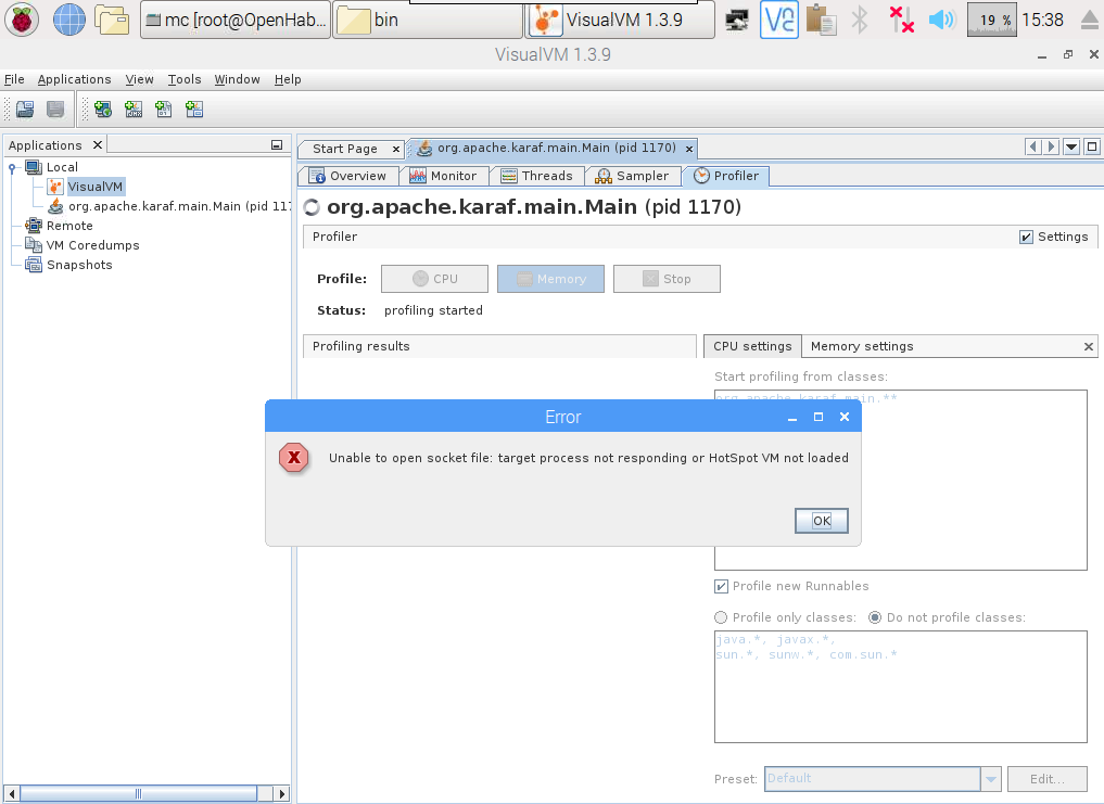

Hi Kai, I now also managed to get a GUI and VNC on my RPI. But I cannot connect to the local process using VisualVM:
Any ideas how to solve this? I tried as user openhabian and root. I was unable to start the application as openhab user, so I don’t know if it would work this way.
