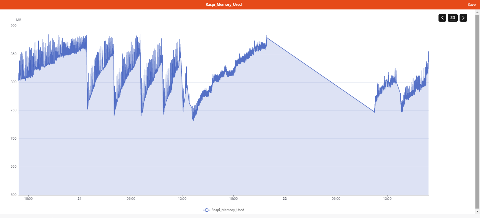

a short question, how is your memory behaviour? Mine is very very tight with 1 GB.
Are there some ideas how to Optimzie the performance on a Raspi or figure out how many ram is consumed?

Here my memory statistics from OH here (the “down pointing” are crashes and restarts) ![]()
BR
Franz
