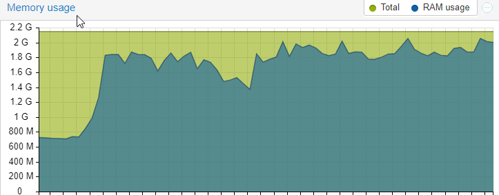

Seems like in Jan/Feb something happened; my average RAM doubled; it’s all mainly under Java/Openhab. Any ideas how to track down what is causing this?

In general, a service like openHAB or a browser and the like consuming lots of memory is not necessarily a problem unto itself. RAM is fast so many such programs are designed to use as much of it as they have a use for without causing impacts to the rest of the system.
So if this use isn’t actually causing real problems (services crashing, excessive use of swap, etc.), then don’t risk breaking something by changing things now.
To really nail down the problem you’ll need to identify exactly what changes in January. You are not even running the latest version of OH 2.5 so nothing has changed with the actual code you are running in OH. If OH is now consuming more memory, it’s not because of a change in the software. You have to look outside of OH itself.
Did you change a configuration? Upgrade the OS via APT?
Even if you didn’t touch anything at all, stuff outside of your control may have changed.
If you plan on continuing to run with an old and no longer supported version of OH, I highly recommend touching nothing. Change nothing. Don’t even run upgrades on the base OS. Even a minor change could break something and since 2.5.11 is no longer supported all we can recommend is to upgrade. The longer you wait to upgrade, the more work it’s going to be.
So, if this memory use is really a problem, then you have pretty much already reached the point where you have to upgrade. There really isn’t much we can do to help and even if we find a problem in the code, you’d have to upgrade to get the fix. It might be something that is already fixed.
