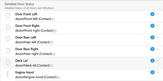

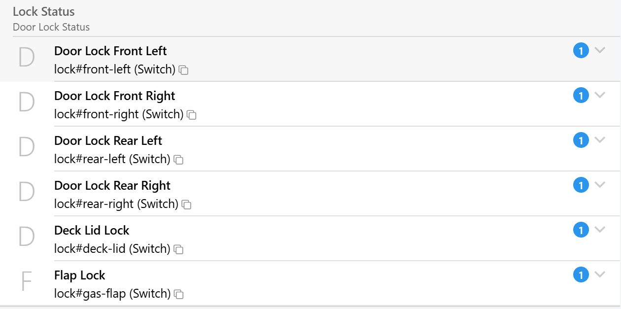

The detailed lock status doesn’t change/update:
The car lock status as well as control work out normal. Am not sure if this has to do something with the recent changes. Could be that i am not up to date here?

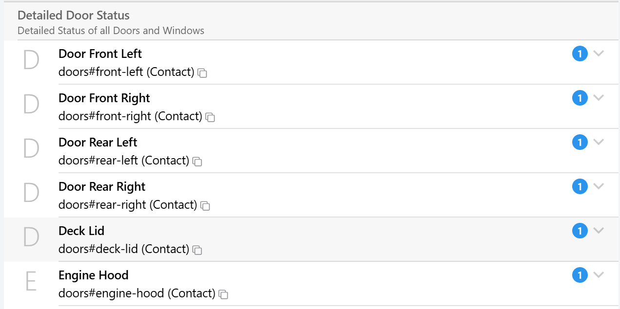

Edit: carried out some more detailed tests. Same is with detailed door status, isn’t updated as well.
@OpenMarcus : do you use “Detailed Lock Status” and “Detailed Door Status”? If yes, can you confirm that they work out for you?
Hi Willi.
Detailed lock status stopped 22.07.2026. I only receive vehicle lock status.
Thanks for your quick response. Then we both see the same issue. Hope that Bernd @weymann can figure out something.
