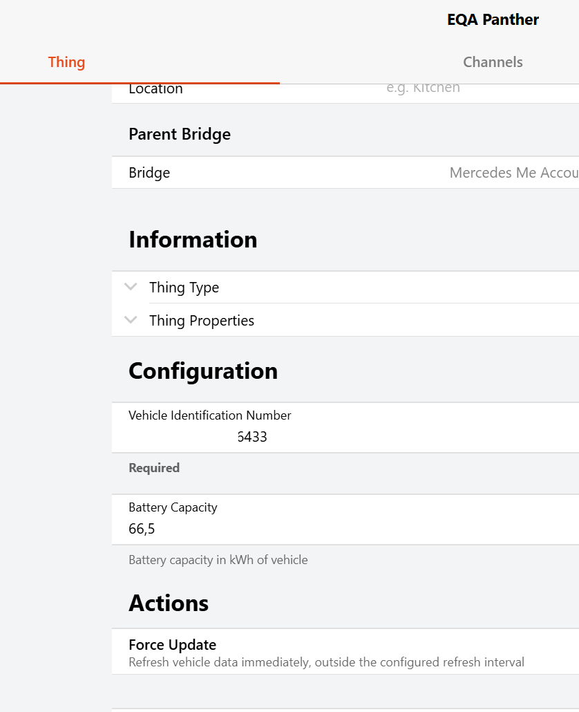

Marketplace jar in top post is updated. See readme with new introduced action forceUpdate.
The happy use case
  • rule checks for change wallbox charging. Not plugged, unplugged, … whatever
  • call rule action forceUpdate
  • mercedesme binding will recognize vehicle is charging and updates stay active
  • after charging ends normal refreshInterval takes place again
Manual test of action can be triggered via UI in things section:
