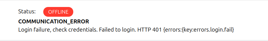

Since some weeks the binding is offline. Reason:
Pretty sure the password hasn’t changed and i can still login via browser to mercedesme. Anything i could check?

No token available because login fails:
2026-01-25 10:27:39.800 [TRACE] [ercedesme.internal.api.Authorization] - Step 1: Get resume code 200 - [https://id.mercedes-benz.com/ciam/auth/login?](https://id.mercedes-benz.com/ciam/auth/login?
2026-01-25 10:27:39.831 [TRACE] [ercedesme.internal.api.Authorization] - Step 2: Post Agent 200 -
2026-01-25 10:27:39.855 [TRACE] [ercedesme.internal.api.Authorization] - Step 3: Post username 200 - {“result”:“GOTO_LOGIN_PASS”,“country”:“DE”,“lang”:“de”}
2026-01-25 10:27:39.887 [TRACE] [ercedesme.internal.api.Authorization] - Step 4: Login 401 - {“errors”:[{“key”:“errors.login.fail”}],“trackingId”:“6f4b2fa7f8b462c7f06e68f1696bba1e”}
Your usename is accepted in Step 3 so this is correct
Step 4 the real login reports error Login 401 - {“errors”:[{“key”:“errors.login.fail”}] so all points out the password is wrong.
Please triple check - any typos or password changed during the last weeks.
OK, used the openHAB official plugin, worked like a charm. WTF….but anyway, thanks so much for your help :slight_smile:
