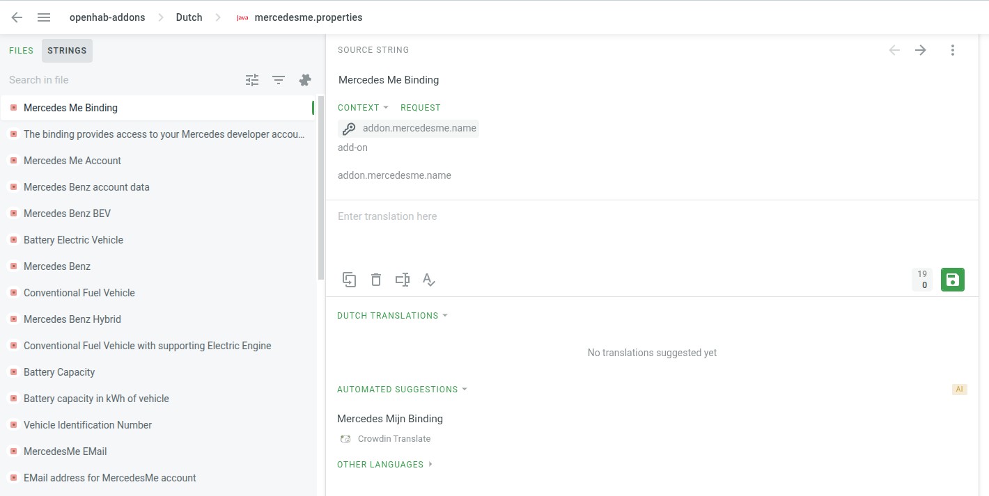

Looks like no Dutch language was submitted yet for the MercedesME binding, but there are a lot of suggestions (AI generated) from crowdin directly which can easily be used by just saving it:
Somebody must “apply”/save the suggestion and also check that it’s actually good, and then a proofreader must approve the translation. Only when that’s done, will the translations make it into OH. But, anybody can do the “saving” of the suggestions, as long as they verify that they are correct, and correct those that aren’t. After that, it’s up to the proofreader to approve them.
