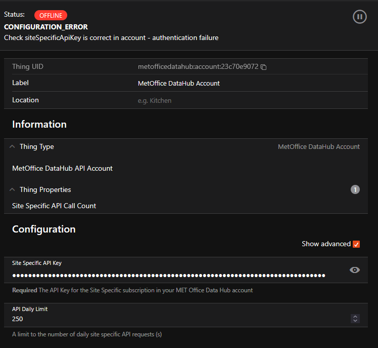

Trying to get the MetOffice DataHub binding to work, but having issues with the api key auth.
openHABian 4.3.5 running on a RPi 4
I’ve created an account with MetOffice DataHub and obtained a site specific api key.
However when the key is entered into the MetOffice DataHub binding, it fails with an auth error.
CONFIGURATION_ERROR
Check siteSpecificApiKey is correct in account - authentication failure
I’ve confirmed they key works using a call through both Postman and Metoffice’s own api explorer, so it is not the key that is at fault.

To help anyone diagnosing the problem, this is the config. It’s pretty simple which is why I’m head-scratching.
