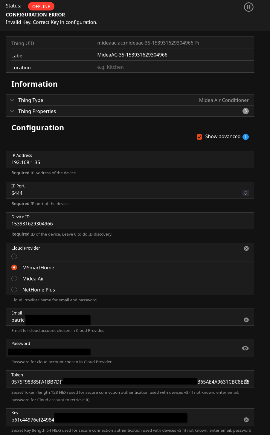

I just updated to OH5.1.3 and got my hands on the Midea AC binding. I followed the config-steps of the doc and README, which got me the token and key from the “cloud” via my email address and password.
Unfortunately the binding still says Invalid Key.
How to debug this from here on? I’m ready to help.

Nevertheless I tried NetHome now. I could connect to the AC using the IoS APP. Using the credentials in OpenHAB leads to the same problem: I get a token and a key, but OH says Invalid Key. Back to start…
I found the msmart-ng-script, which discovered the device on the local network and puts out the key and token. Inserting them to openhab fails the same way as before.
