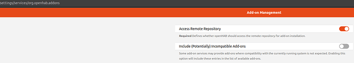

The binding Miele Cloud is not available for installation. There is only a binding Miele@home available for installation but that is a different addon.
But you get a blank screen on /settings/addons ?
I’ve setup a new host using docker and after initial login I get under /settings/addons the option for both miele plugins.
To be honest I think there’s something up(rather down) in the cache of your openhab instance, but not knowledgeable enough to say for sure. If it’s a cache issue I’m not sure how to clear that properly(if package based openhab-cli has an option, if openhabian I’m sure it’s in the menu). Other than time, it seems not destructive as an action to perform.
