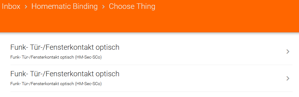

I tried to add the thing manually now and for some reason i have two options for adding a window sensor:
I don’t know why, but i tried both. The second one results in “no channels” and the first one worked and channels are listed now but it still seems to be the homegear thing, because the item get’s named -> homematic:HG-HM-Sec-SCo…
Maybe some Homegear thing and bridge definitions were not deleted completely from the internal JSONDB. You could try and remove the content of the jsondb folder. But this will delete every definition made in Paper UI. You could also grep the files for old Homegear definitions (the ones with HG) and remove them carefully from the JSONDB.
So you mean i can‘t do a step by step (thing by thing) migration with both bridges registered in openhab?
I am not sure because I have the impression that sometimes things are not removed completely from the internal storage.
