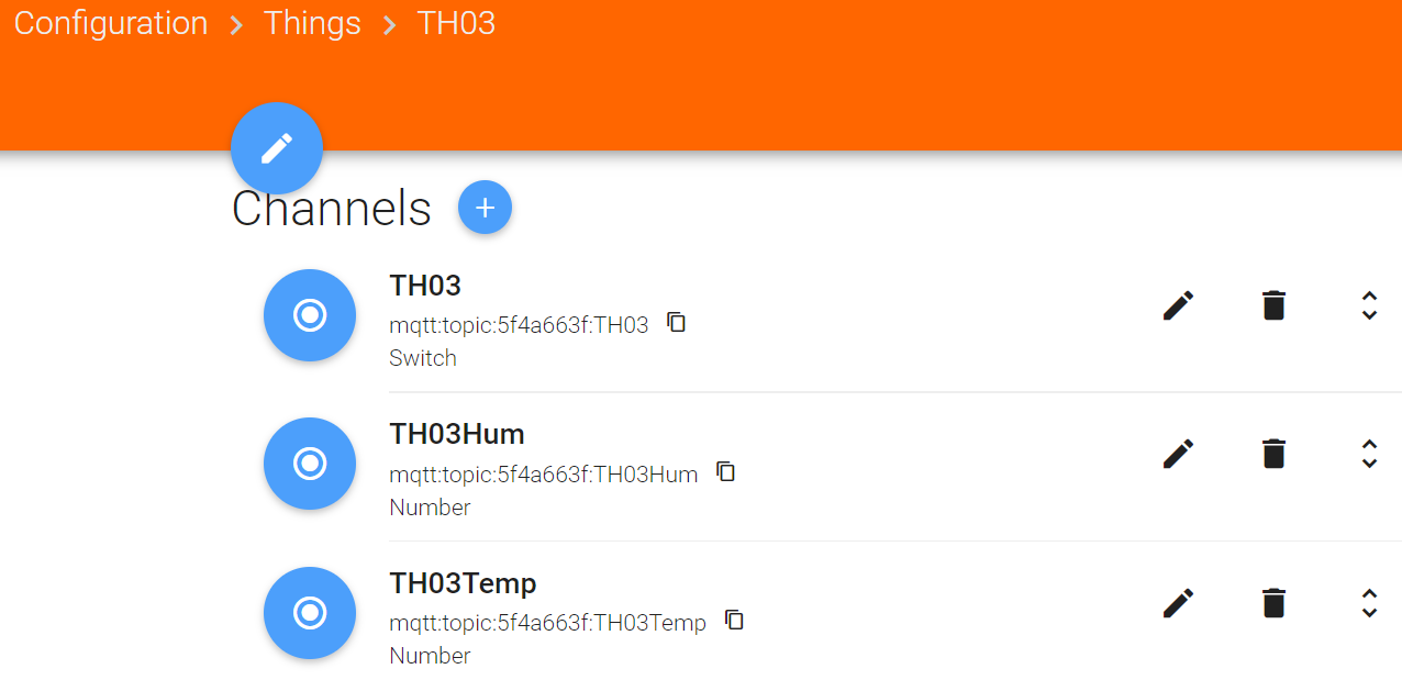

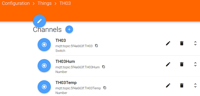

works now, for others maybe interesting when using a TH03 with a SI7021 sensor
Items:
Switch TH03 {channel=“mqtt:topic:5f4a663f:TH03”}
Number TH03TEMP {channel=“mqtt:topic:5f4a663f:TH03Temp”}
Number TH03HUM {channel=“mqtt:topic:5f4a663f:TH03Hum”}
Sitemap for the sensors:
Text item=TH03TEMP label=“TH03Temp [%.1f °C]” icon=“temperature”
Text item=TH03HUM label=“TH03Hum [%.1f %% ]” icon=“humidity”

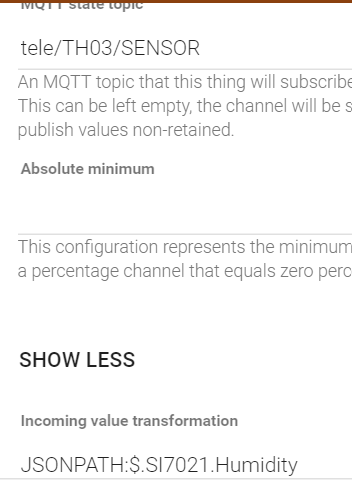

and this is the example for the humidity channel:
