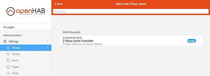

One other point - don’t forget to copy over the security key in the controller thing from your OH2 system
I probably should have mentioned that first step earlier, so apologies for that but I had kind of assumed that was a given that the controller needs to be created… I should remember - nothing is a given
Just want to add, if it helps: when I migrated from OH2 to OH3 I just moved the userdata/zwave folder to the new instance, and after I added the controller everything was discovered and added flawlessly. So I guess that’s to be considered when you do an upgrade.
