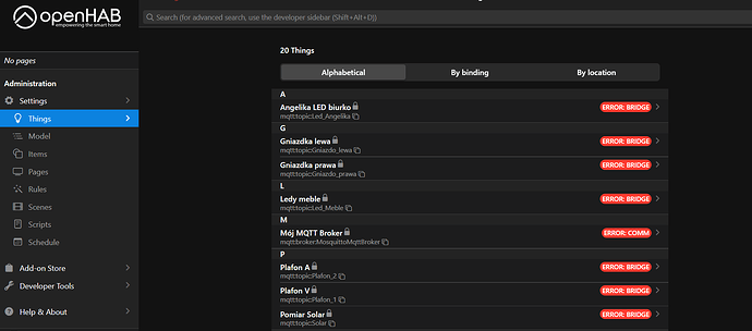

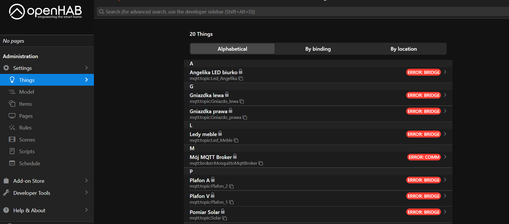

Thank you for the tip, the configuration has been copied, but nothing is working for me at the moment, I have to continue.
Not everything is compatible between the versions. Does the openhab.log file show error messages ?
