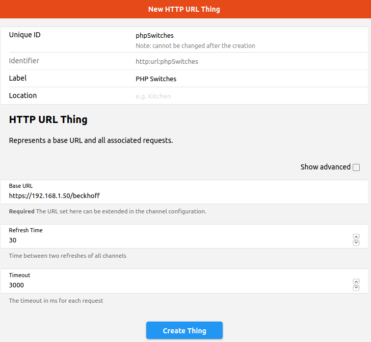

Thing

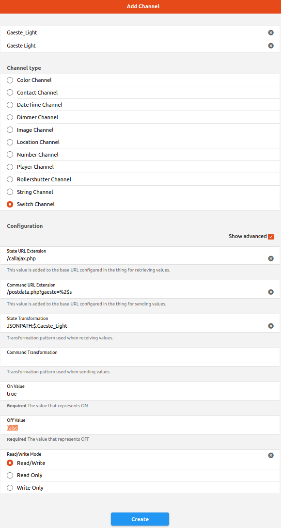

Channel
YAML
UID: http:url:phpSwitches
label: PHP Switches
thingTypeUID: http:url
configuration:
authMode: BASIC
ignoreSSLErrors: false
baseURL: https://192.168.1.50/beckhoff
refresh: 30
commandMethod: GET
timeout: 3000
bufferSize: 2048
channels:
- id: Gaeste_Light
channelTypeUID: http:switch
label: Gaeste Light
description: ""
configuration:
onValue: "true"
stateExtension: /callajax.php
offValue: "false"
commandExtension: /postdata.php?gaeste=%2$s
stateTransformation: JSONPATH:$.Gaeste_Light
