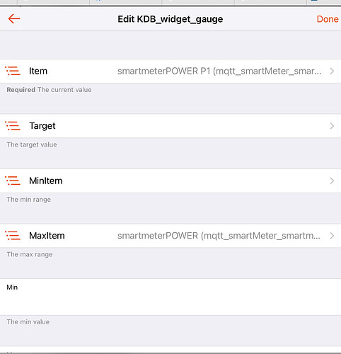

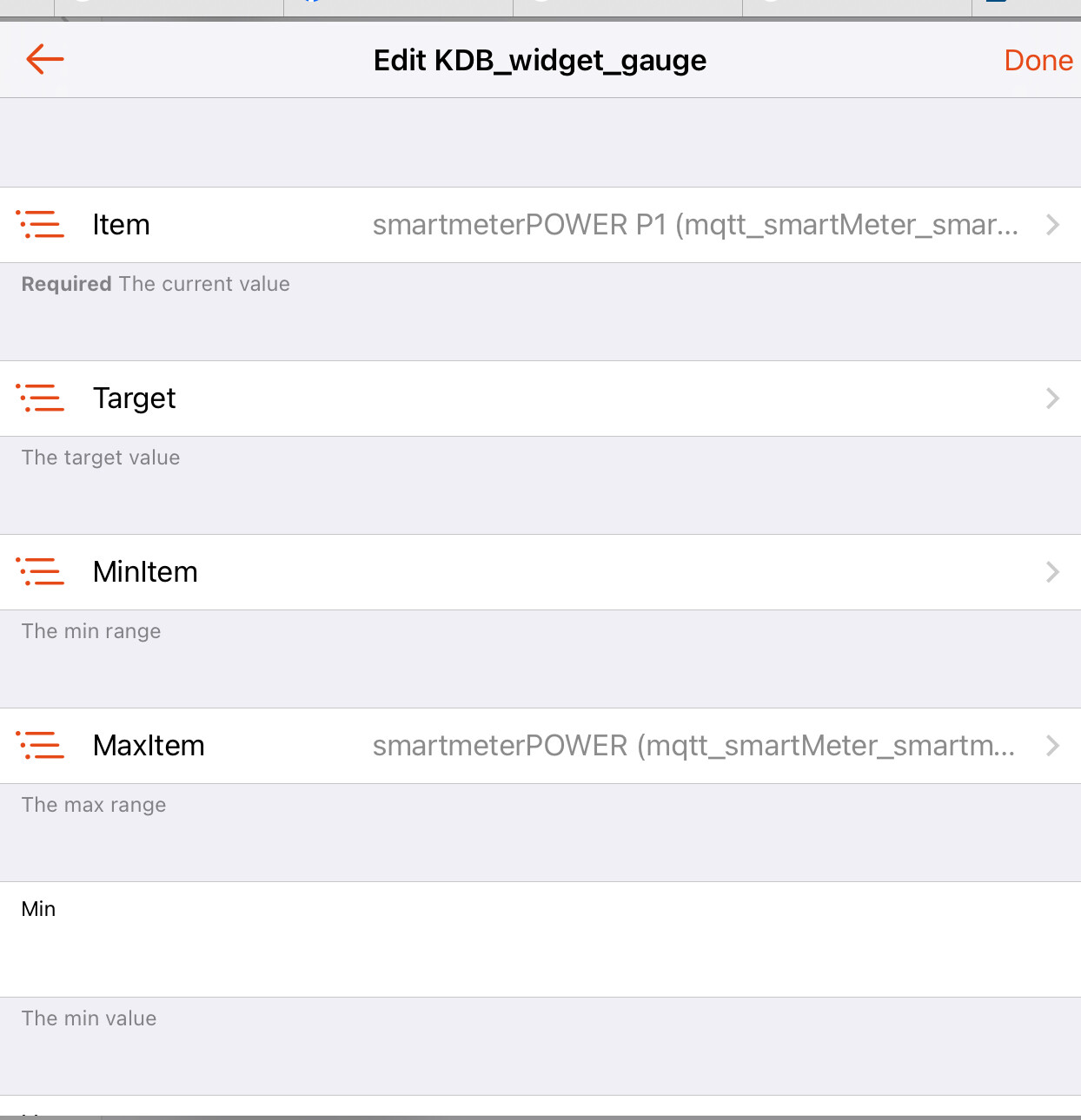

Hey, I don’t want to modify the widget, but to enter the minimum of some items as MiniItem of the widget. Can you give an example ?

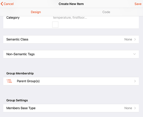

I dont find a way to select different items of the same type to be a member of a group.

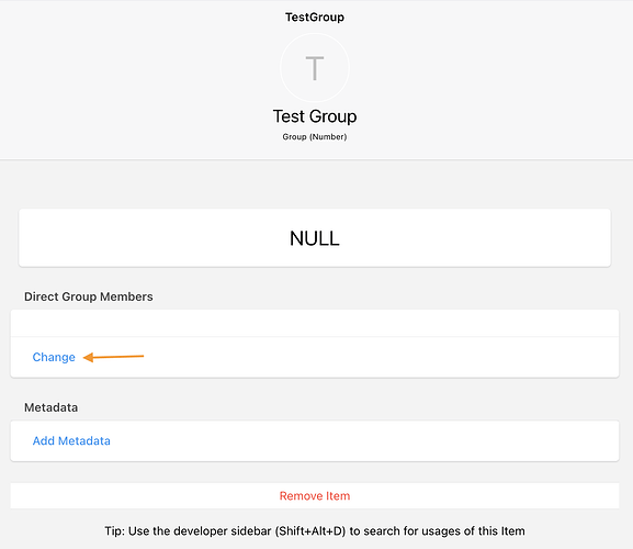

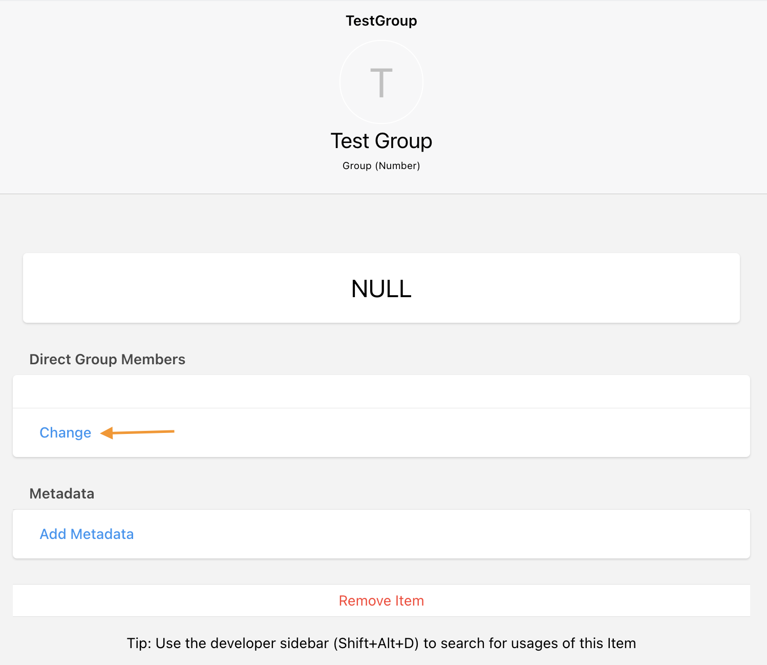

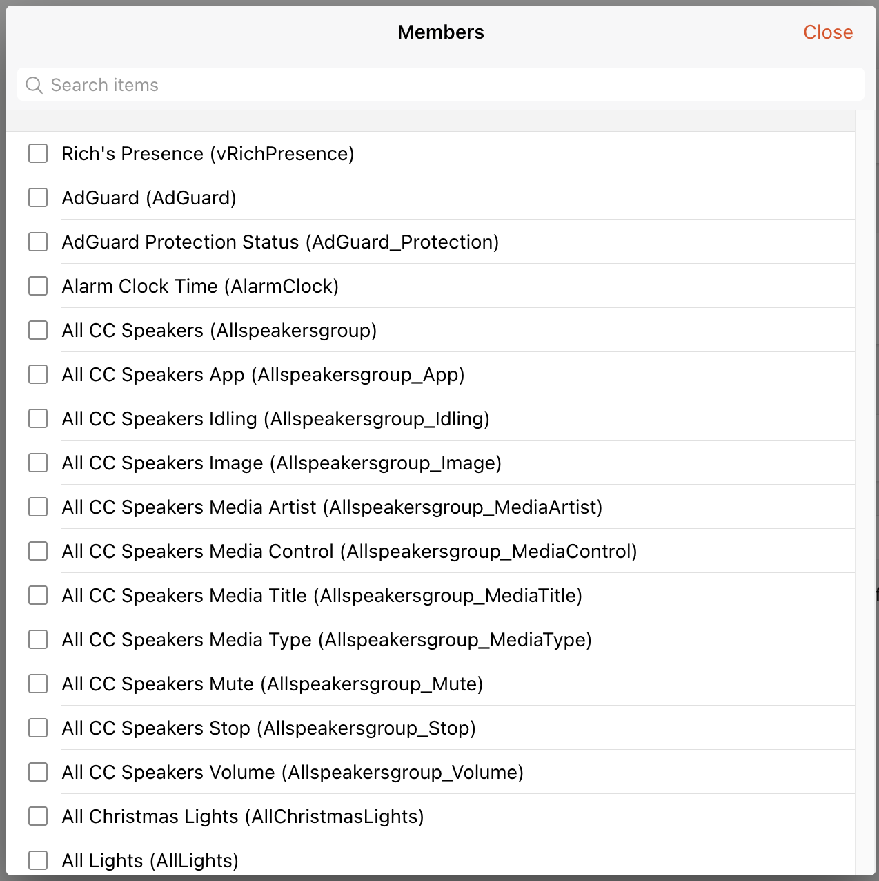

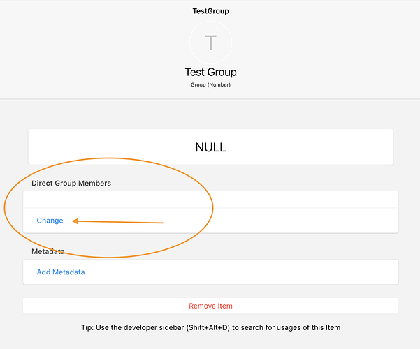

Navigate to settings → items → your group item and under where it says “direct group members” there’s “change” which will bring up the list of all your items you can search through and add a checkmark next to the ones you want to be Members if the group.

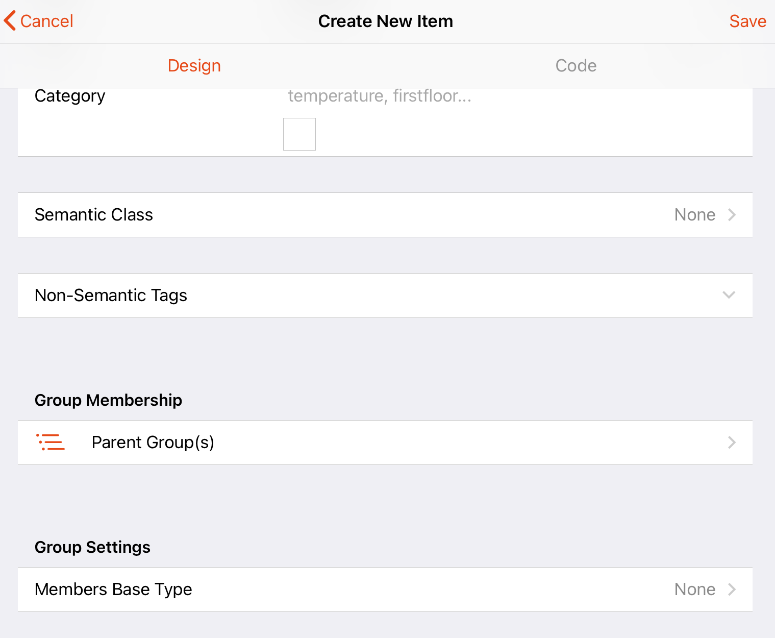

Thank you, but there is no direct group member :
Von KDBs iPad gesendet
You have to create the Group Item, before you can add members to it.

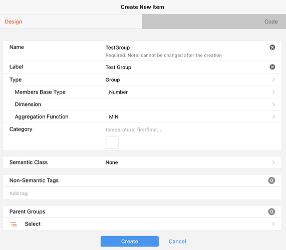

To repeat the steps I outlined above more clearly:
  1. Navigate to Settings → Items → +
  2. Set the Item properties as desired with the following:
    a. Type: Group
    b. Members Base Type: Number
    c. Aggregation Function: MIN
  3. Click “Create”
  1. Navigate to Settings → Items → Your newly created Item

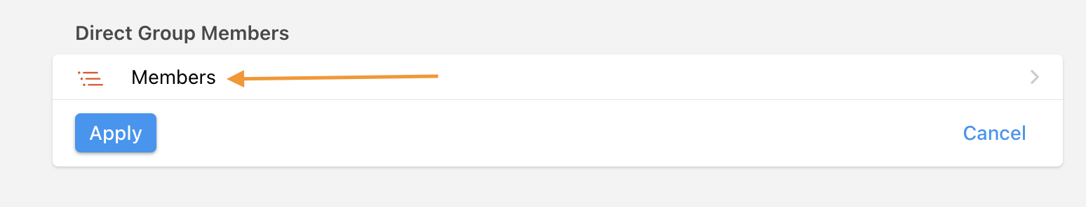

  2. Under “Direct Group Members” click “Change”
  1. Click “Members”

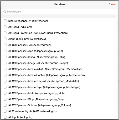

  1. Select the Items you want to be members of this Group
