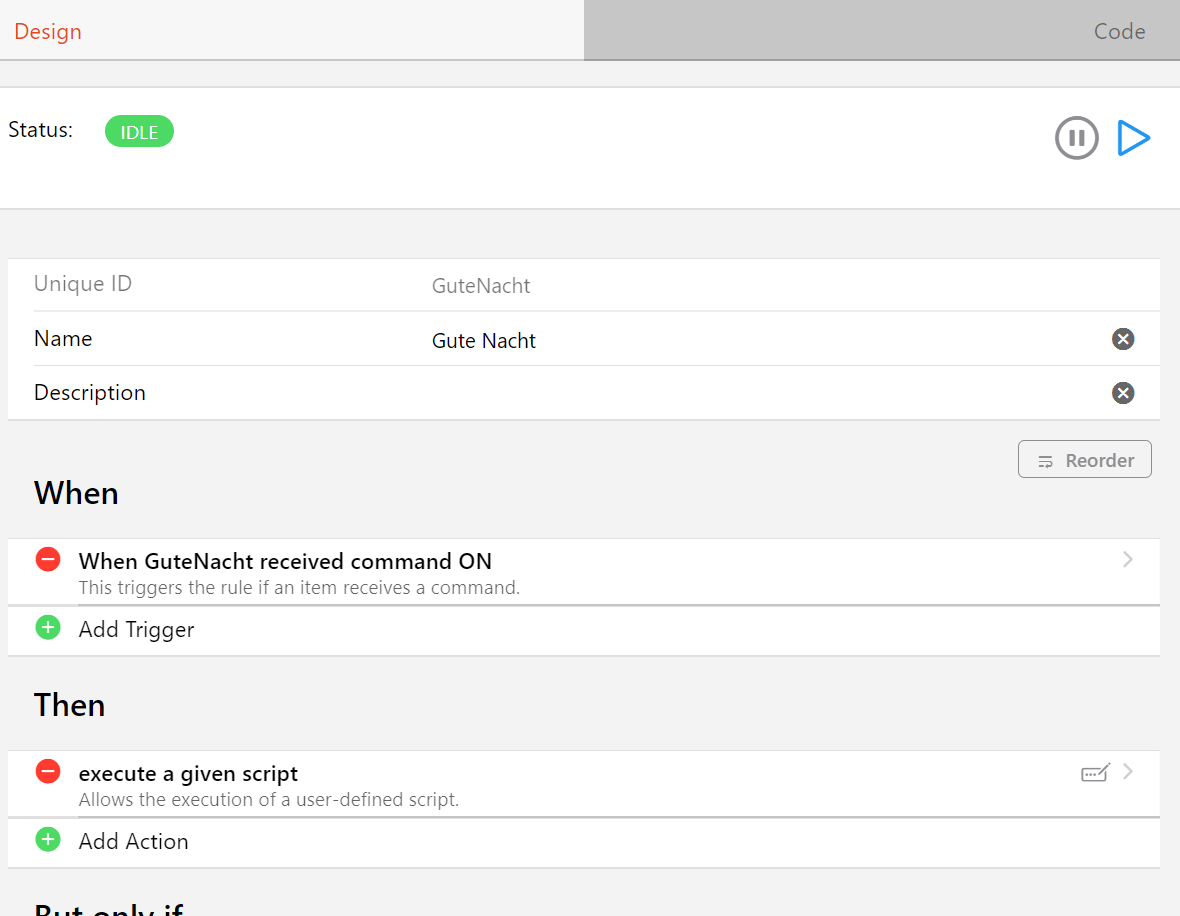

When you save the same code in MainUI, then this is the result in your log file:
2021-11-20 14:06:12.163 [INFO ] [openhab.event.RuleUpdatedEvent ] - Rule 'GuteNacht' has been updated.
No, that’s just how the rules engine works, not the UI. Modules are just declarations that are saved and they are only evaluated when the rule is run. In case of script modules (actions or conditions) this means the script is parsed when the rule is run, not before. You can easily test-run your rule, ignoring triggers and conditions, with the Run Now button (or Ctrl-R). If you have a syntax error it will appear in the log.
If you’re not sure about actually running the code and just want to check the syntax, maybe temporarily inserting a return; statement before any sensible code would work.
