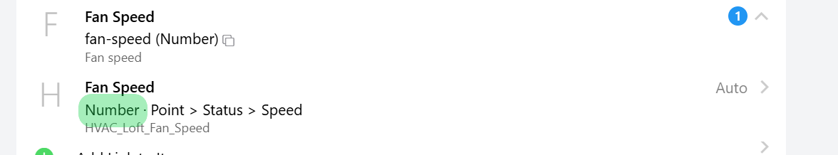

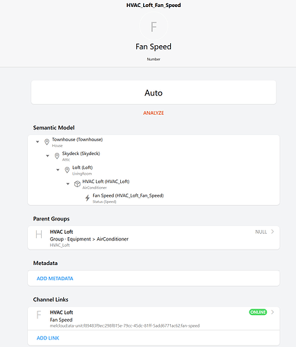

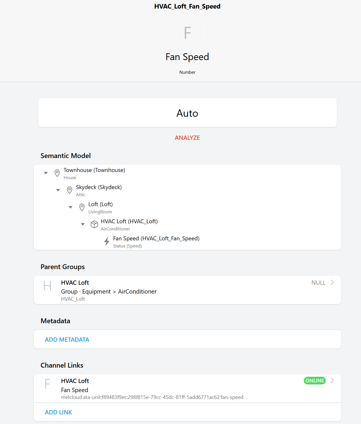

Curious! For analysis please post screenshots from your item settings to check why it’s formatted as a date.
  • is item a Number like in Screenshot 1)?
  • any Metadata settings like in Screenshot 2)?
Of course it wasn’t. :see_no_evil_monkey:
It was a String. I used the items file from the previous binding in order to avoid re-creating all items and the sitemap.
